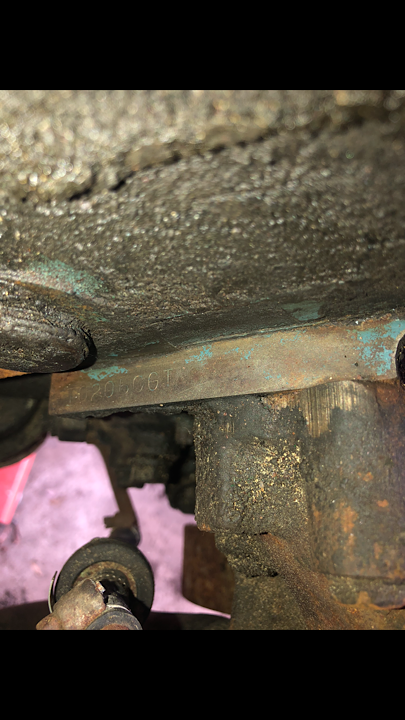

I found a September 69 date code 512 block with a CGT Suffix partial vin on oil filter boss
Looks like it’s From a 70 impala 4 speed car. Just putting it out there if anyone has the car

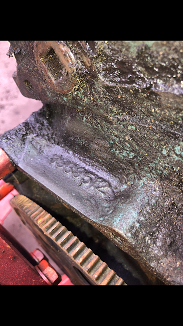

Can you post the full engine assembly date and the casting date? CGT is 70 fullsize LS5 Police! Unusual suffix code. Car was not in my database.

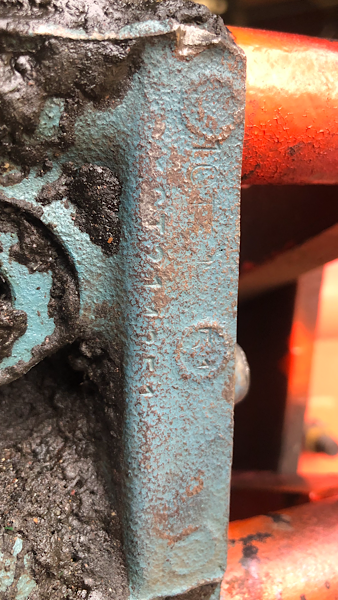

Partial vin stamp

Suffix pic

Casting

10T214351 OR 10T214251
I see two different font VIN stampings in the rough casting area. Both seem to be the same partial VIN.
Pad is T0206CGT
