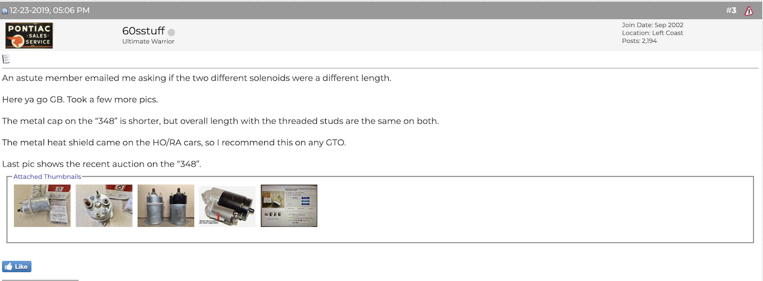

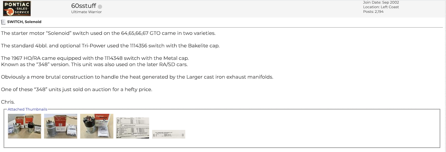

funny you should ask about this Chuck as I took these screen grabs a couple days ago off PY
