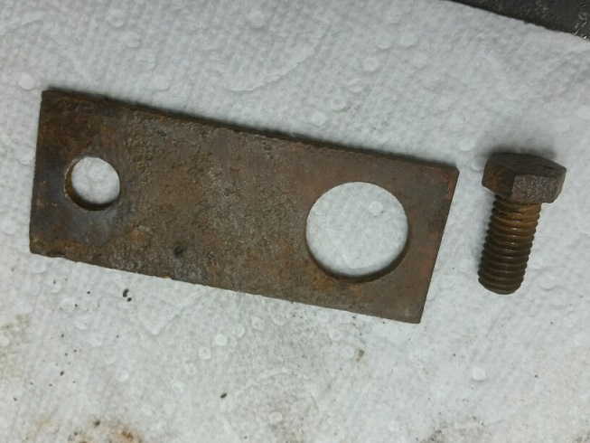

Searched and searched but couldn’t find the answers to my questions...
I’m going to install the lift brackets on my ‘68 Camaro BB L35 engine and have a few questions:
1. Are the bolts longer on the intake manifold to compensate for the added thickness of the lift bracket? If so, what is the length? Also, are they shouldered/non-shouldered and does anyone sell them (AMK?).
2. What type of bolt is used to attach the rear lift bracket to the cylinder head? Size?, shouldered/non-shouldered?, bolt+lockwasher or just a bolt?
Thanks,
Bob

Bob, the front lift bracket bolts are longer, black phosphate grade 5. The rear bolt is also black and grade 5. I have restored and unrestored sets of you need them. Thanks, Rich

I have a rear bracket with the bolt. The bolt has a M on the head and is 7/8 long.
Freddie

I forgot to mention, no washer, no shoulder. I'm assuming that this is correct. It was attached to a '68 head that I've had for a long time.
Freddie
I just pulled a couple of these off of 1970 402 motors and they were the same - 7/8 bolt with no shoulder, no washer.
