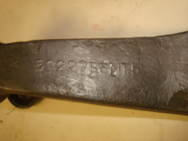

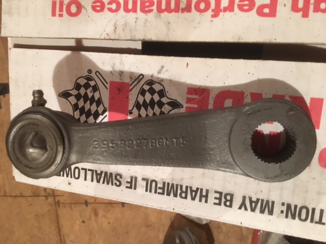

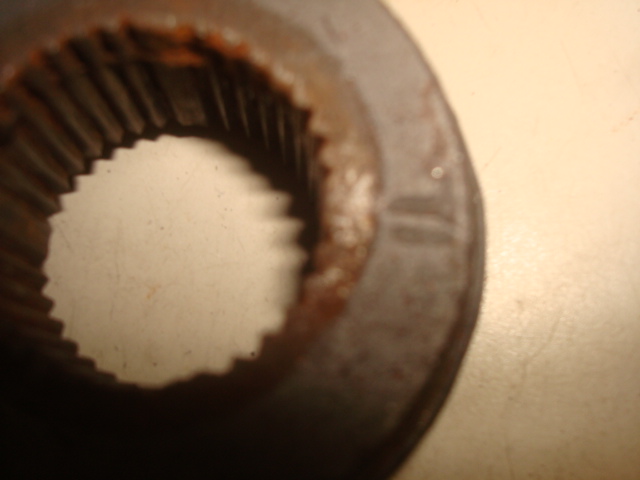

Anybody have a fast ratio pitman arm that they are willing to part with or trade for a manual arm? Pictures of manual - nice part.

Bergy, I guess I'm confused as to which pitman arm I have. Its hard to read the casting number on the one you have pictured. Is it 3953327 BGMT5?
Mine is 3953227 GMT1B. It is on an early 69 manual box that I have had for years so I assumed it was correct for a manual.

The pitman arm 227 is the quick ratio, and used on both manual and power steering, however the PS arm has a much larger splined hole. Again the casting # is the same, but the power and manual arm are not interchangeable.

Steve is correct (of course) - larger hole on the PS arm. Also, sometimes has a "P" stamped by the hole.
