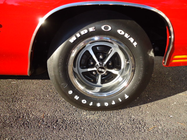

I've got my 14 " SS wheels all blasted and ready for paint. I want to just paint them with correct color spray bomb cans. Anybody know if correct colors are available for back side, front black, and front silver?

Just finished rattle canning a set last fall.
I used Krylon Stone Grey #41605 for the backside,and Rust-oleum #7277830 Matte Nickel for the silver areas.
And a special mix a jobber made up in a rattle can for the insert graphite off black color.It's not Black,but a dead on match for the original off black insert color.

Rick -- looks like they came out pretty good ... TAZ

Thanks..Hard to show the unique insert color over a computer screen,but they did turn out very well when seen in person.The sunlight helps make the inserts pop and show their true hue.

#1403 Dull Aluminum works pretty well on the front, Dove Gray on the back and black with a charcoal metallic over mist on the inserts.
