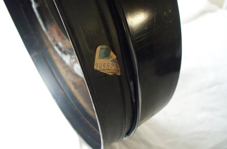

Looking for an orig Demco cowl induction spacer # 3955233 used on Z28.

Here's what he's looking for.

302cid used extension #3955233.
350cid used extension #3955232.

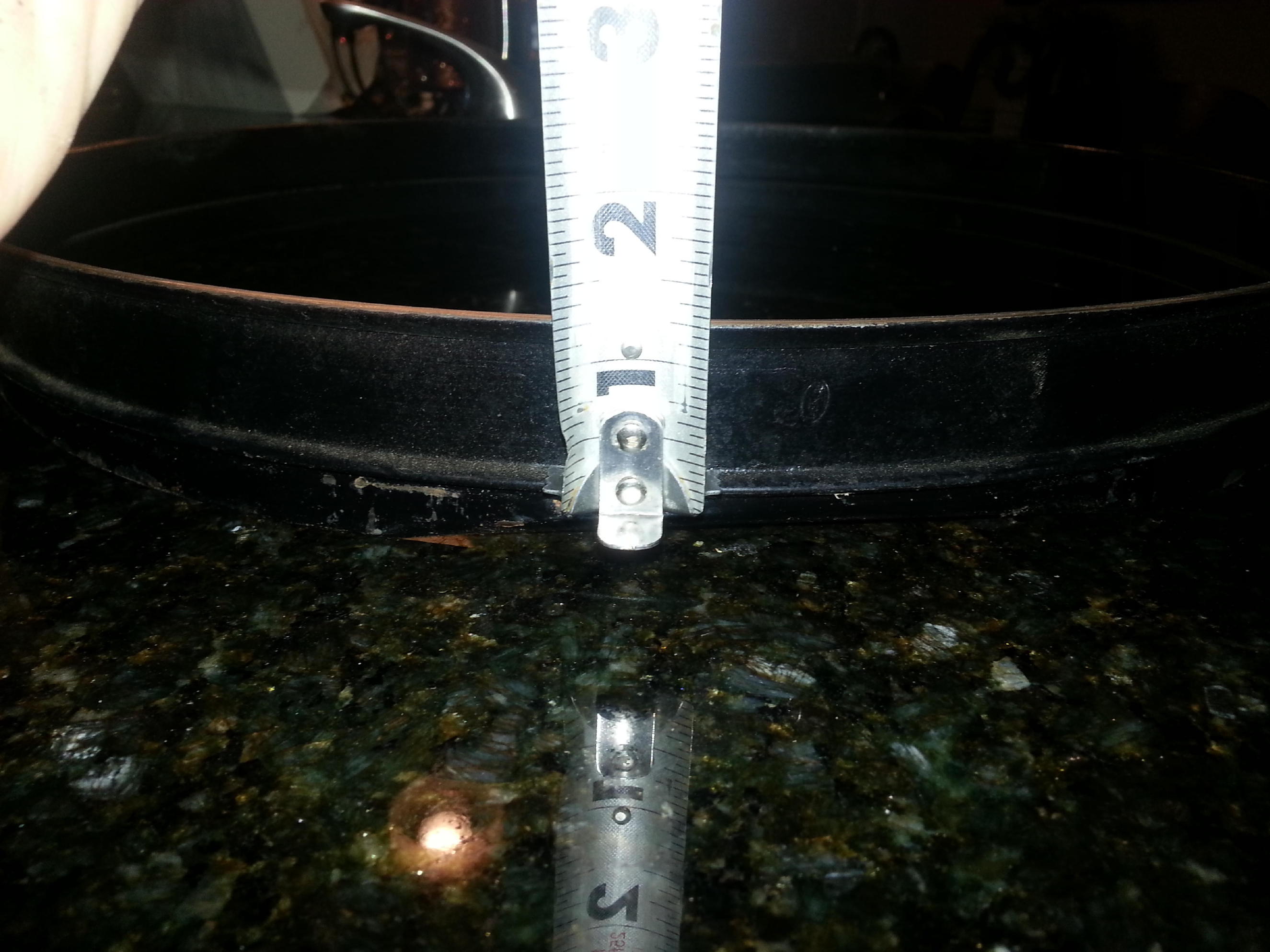

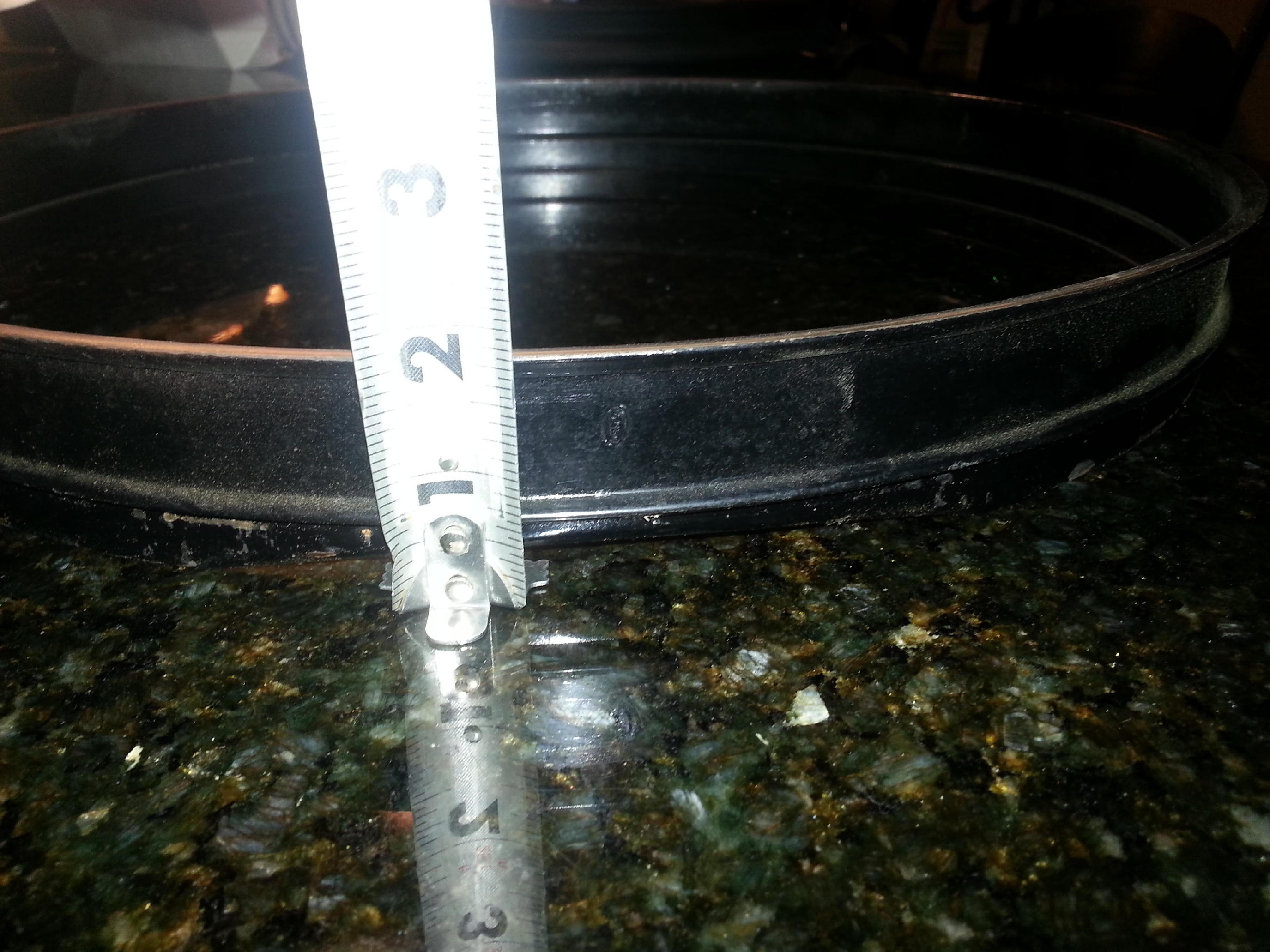

im a little confused on the correct height of the spacer - the one on my orig late build 69Z measures 1 3/4 total height and the height of the area above the air cleaner is 1 1/8.
soooo, where is the 2 1/4 coming from or I don't have the right stuff on my car, or there are different ones.
being a late car, my cowl air cleaner has a ridge on the bottom, similar to what has been found on the late cars.
this car is a 09C car.
thoughts?

I checked the one on my orange car and it's about two inches overall and one inch from the top of the ridge to where the flange sits. This is identical to your measurements. What you have is correct my note was incorrect (possibly for ss350).
