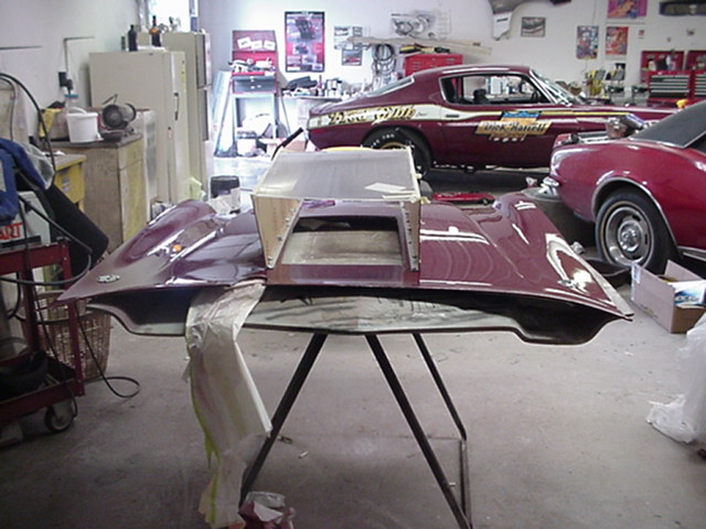

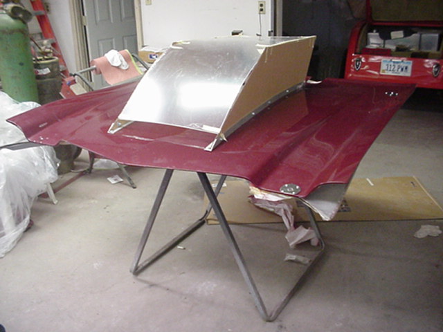

I making the red scoop for the 70 Gibb car.

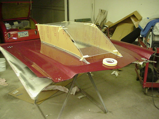

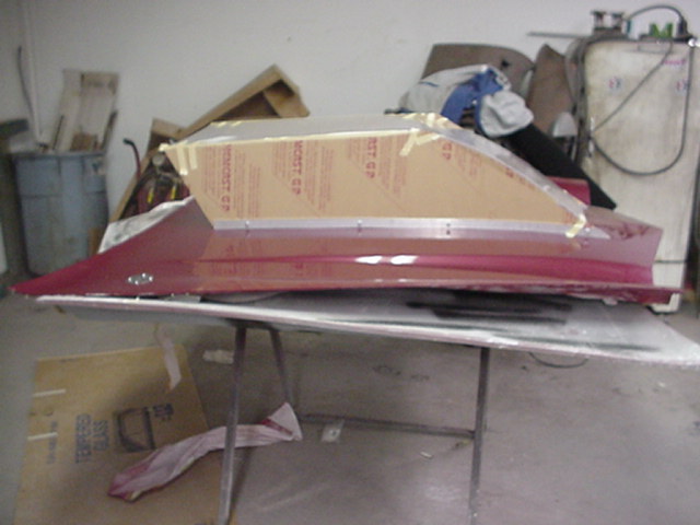

O K before I do this. {attachment} anybody know if you heat plexiglass to bend it to a shape?

I think Lexan would be a better investment than Plexiglas..... it's not breakable.

Keith, Are you going to race the car?? If so at 130+ my scoop
came apart. I have used every type of glue that they say will work. The only one that I found to work good is

The glue I used is IPS Weld-on #16
IPS Corp.
Box 379
Gardena,Ca 90248
It worked the best. If your going to race 1/4 mile I would put brackets in the corners and screw them together. Kim
