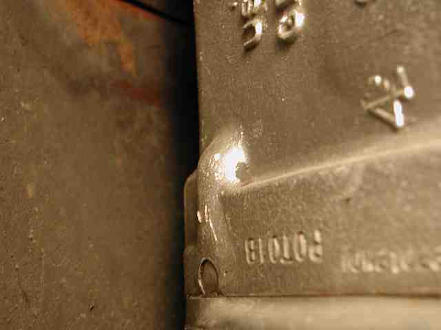

Ok, I know I am open to all kinds of opinions both good and bad. However, it seems to me that this site has more experts than any other site. I am about to finish a rotisserie restoration on my 1970 L78 Nova SS. The car has the vin on the engine and transmission. However, I have not been able to obtain any other documentation. In my limited experience, the stampings and broach marks look legitimate. Please way in on what your belief is as I will be putting the car on eBay in a few weeks and need to get the opinions out now and not while it is on eBay. I am not a dealer but a (58) years young Warden of a Correctional Facility here in Maine and I love all types of Muscle cars.

Attachments - The Supercar Registry 333695-trans.jpg 333694-vin.jpg 333693-cko.jpg

Hi Al, The VIN stampings on the engine & trans are different, at best one or the other is not original.
Jerry

No red lines in 70. White stripe only. I can see in your photos that it had a SS tailpan. I can't see the holes in your before paint pics. Did you change it, or are the holes still there? I was thinking that the motor changeover happened later in the build year, somewhere around Jan. That Nov might still have 840 heads, and 163 intake etc,but I could be wrong. Most body changes took place around mid Jan.
Some will buy it without docs, some won't. Have you tried to find the original owner. Being somewhat connected to law enforcement, you may have a shot.

291 heads and 569 intake are correct for that time frame....I don't know of any 70 L78 Novas with the older 840 heads or 163 intake. It is true there were many changes mid-year....door hinges, throttle cable, smog plumbing, F41 sway bar, etc....our black 70 4spd engine was built 1 day after this one and it has the 291's and 569.
