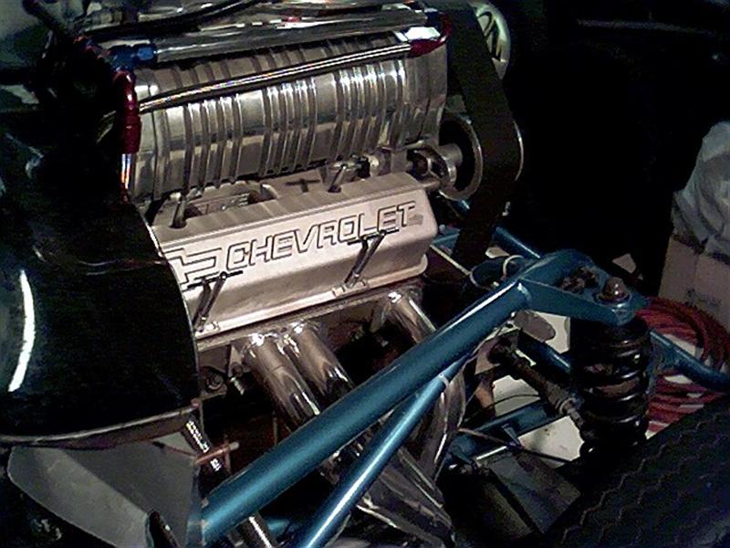

al, here are a couple pictures of my 2 1/4 in super comps. these are very close to equal length but one tube goes outside the frame rail on both sides.

<font color="blue">When is the last time you detailed that car ... yuk, what a mess!!! </font>

i take it you saw my fingerprints on the radiator bracket.......time to head out to the garage and fix that. i did have a blue rag somewhere but dont know where i placed it..
