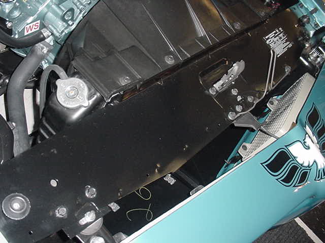

Its a base Firebird, wrong rad support for a 70

you mean the whole core support is wrong for the car? It is obviously an a/c car. I just figure if it came with a 12 bolt and still has it, the car is worth what he wants for it in just parts.

By the VIN # you posted, it's a base Firebird. The BOP 12-bolt was only available in the 70 Trans Am, and it's quite rare. Did the guy say it had a 12-bolt?

yes the hole support has been replaced sometime in its life if you look at the top of the rad support it has 2 dipresion one on each side it should not have them all 70/72 had a flat top panel here is a picture of a correct one
