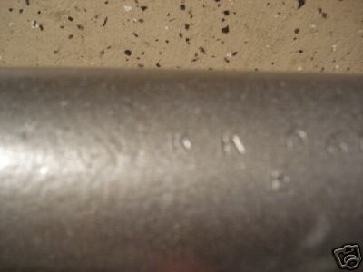

Any thoughts on this 67 chevelle rear as far as the code stamping and posi stamp, thanks ..

King is that a KK its not clear. Jim

KK yes, its not mine.

Don't know about '67 but in '69 KK was the 4.10 posi rearend. Probably not all that common. The fakers are getting pretty good. I guess a microscope could check to see if the stamps are fresh, or old and weathered.

12 Bolt Axle Codes.
http://www.chevellestuff.com/generic/axlecodes.htm#1967

all the camaro posis ive seeen had the E eaton posi stamp, yet the chevelle posis i have dont??
