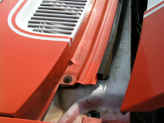

Here are some. I am sure there are plenty more examples out there.

-----Thanks Darren and Mike. Darren,,, I guess the one thing I could take away from your two pics is that the cowl appears to have been taped off, and the mask tended to lean one way or the other over the edge. Is that a recurring theme???......Bill S

Bill
I looked through a bunch of old print photos I had and found a few original 69Z's.
It looks like the rear stripes ended with a overspray pattern.
However, as in the pic's posted here I believe the front cowl was taped off at the bottom edge.
Mike
