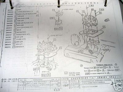

like this.......?
It appears in the 70 Chevelle Assbly. Manual
Jeff

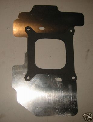

Default Re: Carburetor Heat Shield
one more........
1970 Z-28 NA-9 components...............from Frank Arone's and David James cars
