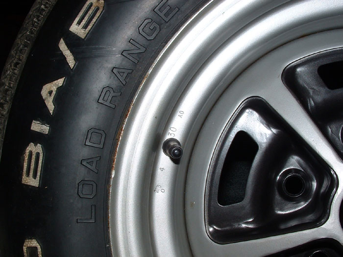

Old 05-17-2006, 01:27 AM
ORIGLS6 ORIGLS6 is offline
Location: Fishin' in the Dark
Posts: 7,410
Thanks: 1,102
Default Re: 5 spoke SS Wheel Paint
ATTN; RICK NELSON.
Rick, Do you have the shots of my spare I sent you a few weeks ago? I can't put my finger on them.
Jim, I sent a few pix of the wheels on my car but I also have shots of the spare which has never been on the ground. Should be a fair representation of a '70 wheel since it's never seen daylight. Unfortunately, even a good digital shot isn't as good as having the real thing in front of you.
Here's the best I have at hand.
Old 05-17-2006, 02:23 AM
YENKO DEUCE REGISTRY's Avatar
Posts: 13,101
Thanks: 727
Thanked 375 Times in 146 Posts
Good pic there Joe/Eric The color of the wheel inserts has been the topic of much debate over the years within the Yenko Deuce community, with no real conclusions yet - except that both black and charcoal have been found.
The set of NOS Magnums pulled from Yenko's shop are still in the Motorwheel boxes with yenko labels on them, and they are reportedly charcoal. Several cars have been found with black, others with charcoal, so it's still a tossup.
I painted mine black bec/ that is what I found on them, and they were original condition. I think the Wargo car has black, but I think Tommy K found charcoal on his original condition a/t deuce. So, it appears that both colors are applicable.
Marlin
Old 05-17-2006, 02:41 AM
Join Date: Mar 2003
Location: Pittsburgh, PA
Posts: 1,214
Here are a few more pics of an original Yenko installed Deuce wheel for reference.
The windows of the wheels on this particular car appear to be flat black. I think 35+ years of crud and sun fading may give it a slightly charcoal appearance. These were late April dated wheels.
Now here is a pic of a "factory installed" Magnum 500 that was on a very low mile unrestored 69 L-78 Chevelle. It definitely appears to be more charcoal in color.
Here's a shot of the light grey backside on the original '69 Firestone Wide Oval spare.
