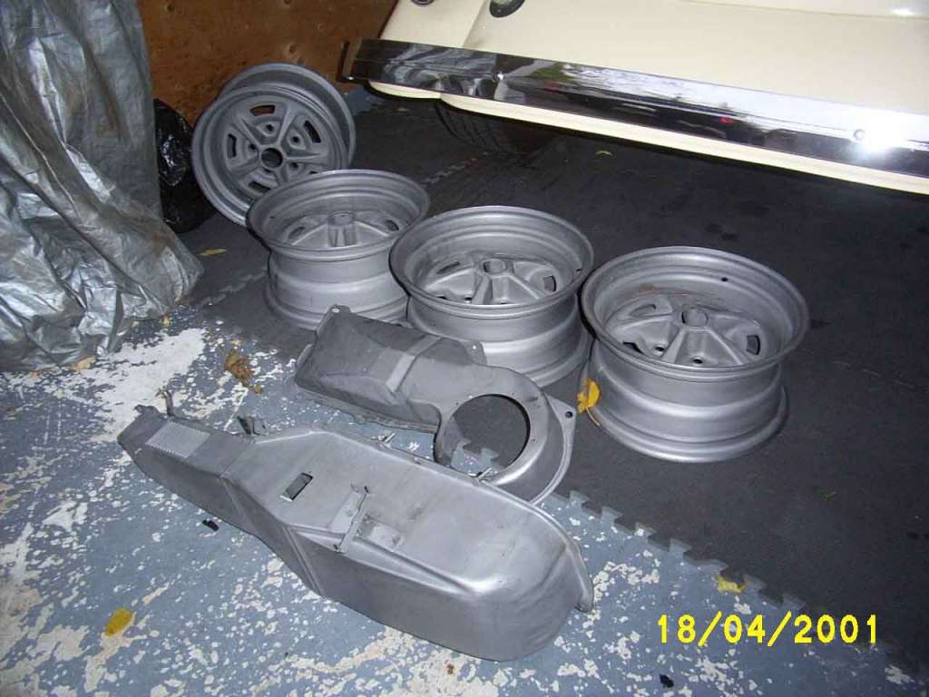

You are on the right track however ,before you embark on this project do an estimate on the parts missing, the parts you will need to replace. Give to the shops only what you absolutely must.In order to keep the costs down.Labour for a good Body shop today is about $60.00 per hour and when they get your car in there It will be a shocker when you finnish the body.You can have the rear end rims,heater box inside and outside,and all the other parts that are rusty
and need lots of sweat to refinish like the drive shaft. Send them for chemical stripping when they come back
they will be like brand new, then prime then yourself
outside a nd then final paint them.

Here is sample .

This company in Brampton does a great job chemical striping parts. A must if you want stuff powder coated.

For others out there around the GTA, I also found a neat wheel resto service in Aurora called Carcones Auto Recycling (www.carcone.com). They blast, prime and powder coat rally wheels for $82 each and will pick them up and deliver them to your local mechanic or tire store.
