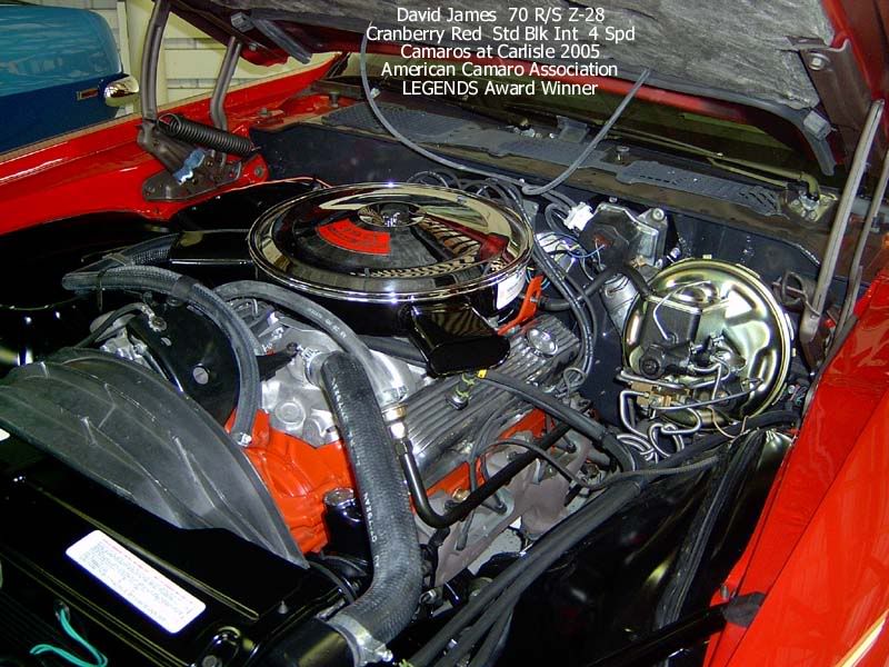

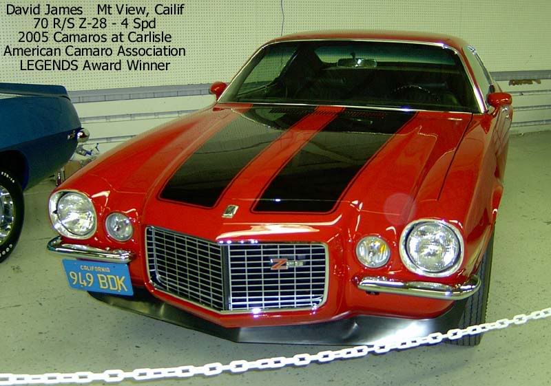

David James brought his California based/built/sold 70 Z to Camaros at Carlisle 2005. One of the best, highest point 2nd Gen LEGENDS Camaros weve judged.
