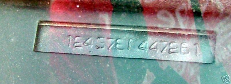

Default Check out this VIN
Is it me or does this look suspicious? EBAY 68 Camaro L in Vin but Norwood Body Tag???

It's an "N", just not stamped very hard. Look at the top, where the impression starts to the right but stops.
An "L" would do that at the bottom.

youve got to be kidding me right?? yes very wrong!

Homemade vin#, very wrong!

I love the correct for '68 Z/28 emblem placement, too!
LOL!
LOL!
Bruce, you took the words out of my mouth. Thats Funny.
