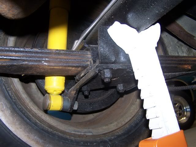

Reline is 6000, 4 leaf spring and EE code on front spring. Rear leafs have a little 1/2 spring with 1 shackle added to the back half. Could this have been for wheel hop?

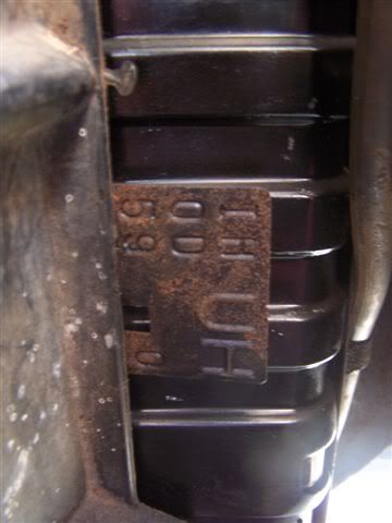

Leaf springs look original and right for a Z, EE code coils are correct for a Z, tach is correct and I think the radiator tag is also correct but my memory is not that good to remember what the radiator tag should be. The little springs attached to the rear spring leafs would not be for wheel hop, more likely to prevent the rear end of the car from. Very nice car.

Yes, the UH radiator code is correct for a 68Z, but it's also correct for a 327 (LF7 with AC).
