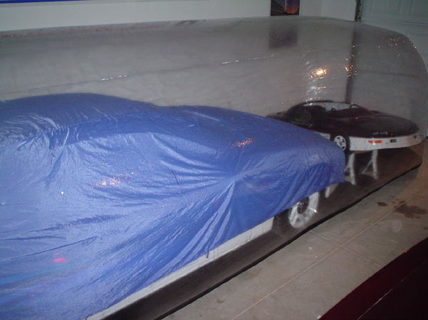

Dont know if this has been discussed but what is a range or a ideal percentage to set the dehumidifier at in my car storage building.Thanks in advance

Car Capsule works well non HVAC storage areas. My small 3 bay garage is climate controlled. Keep your area at positive pressure at all times and you will be ok. Air movement is the key. Kevin Hand has fans running on his cars all the time at his place.
