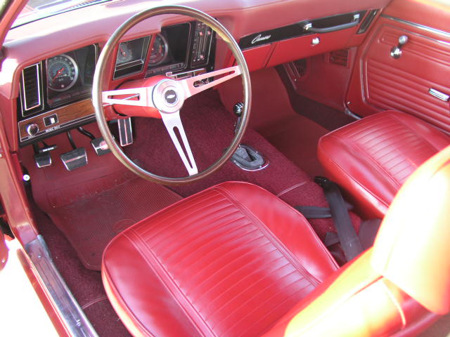

Old 03-26-2005, 08:24 PM
Location: Woodland, ca. US
Posts: 16,051
Thanks: 533
Thanked 4,979 Times in 1,266 Posts
Default Re: help! correct redline tach for 69 396/325 4spe
Here is tach with center fuel guage and no clock.
Old 03-26-2005, 10:20 PM
Mr. T Mr. T is offline
Join Date: Oct 2003
Location: Spokane Valley, WA USA
Posts: 1,423
Hi Mr T,
What would the car setup look like if it had a console but no tach? would a clock be where the gas gage is(right side large gas gage)?
With or without a console, you could have the large gas guage on the right and the clock in the center, or just the gas gauge with no clock. The U-16 gauge option consisted of a tach on the right and a gas guage in the center, just like the picture Charley showed you. However, the U-16 guage option was avaiable with or without a console.
The U-17 gauge option would consist of a gas gauge, water temp gauge, oil pressure guage, and the battery amp guage on the console, with the tach on the right and a clock in the center, on the dash, behind the steering wheel. Good luck!
Tony
