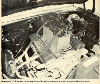

I have set up 2 TR systems for myself and one for a friend who has a street rod. Take this info or leave it but it works. I got this info by trial and error and talking with guys who actually run these cominations on the street and who actually don't LIE to you telling how good their combination runs on the street. I think only 2 out of 10 TR systems I see on street cars actually work decent. Here is the engine out of my mustang-see attachment.
