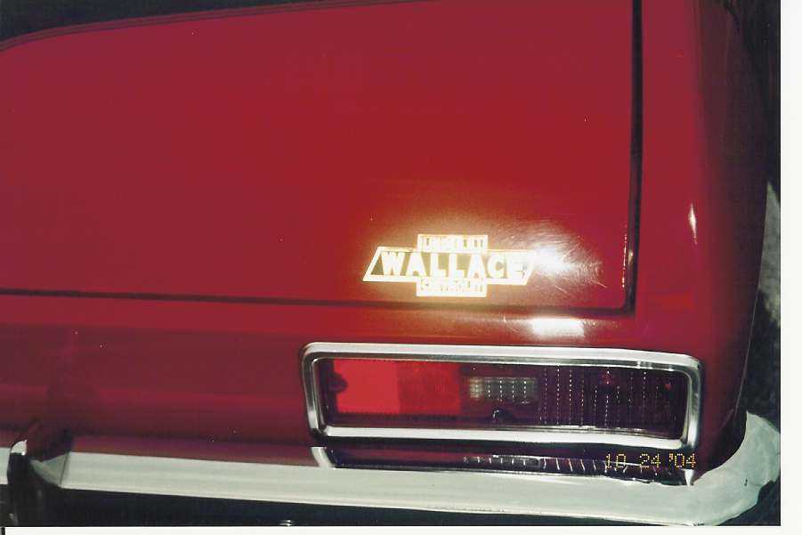

Dealer decal placement for the Wallace Chev. guys.

Wallace Decal placement,
