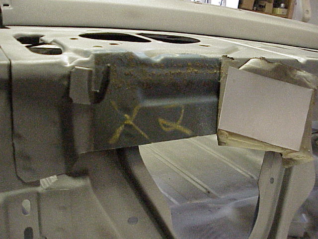

The car had X2 on the bulkhead in the rear seat area also that we preserved

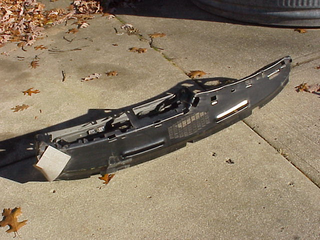

I suggest that any time you are restoring a car and you have it blasted or dipped or what have you that you and your camera should be there!! Then you can make sure that the operator of the nozzle is not going to erase these markings forever. Here is what we found on the firewall

picture of the original BTP orange stamps
