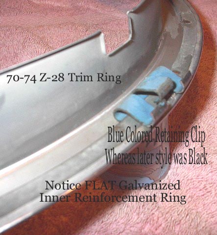

I'm trying to install 4 brand new GM SS trim rings on my 14X7 original SS wheels. They are very tight and I can't get them to go on so far....I don't want to dent them by slamming them on with something. Is there an easy way to get these things on?
