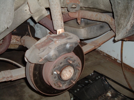

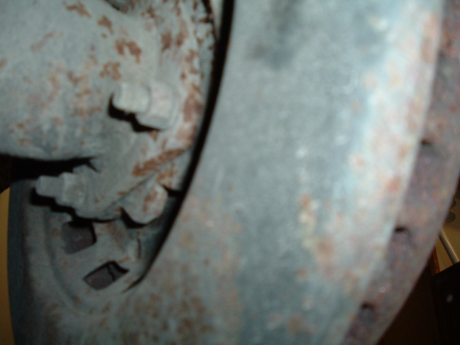

axle info as follows 02559 bu0515g1 531/4"wide flange to flange has the correct rear disc on the axle appears to be factory bolts have no evidence of ever being turned backward 113/4" on the front but the trim tag is way off of the vin the previous owner is trying to get me some more info trim tag 09a 12437los103128 has original gm rivets the vin matches everywhere 12437L526322 .thanks for your input stan in ga.

BU is not a JL8 4 wheel disc rear, it's a drum rear that was converted to rear discs. The date is off and I'll assume it should be something like 0225 and that would fit in the time frame for your car.

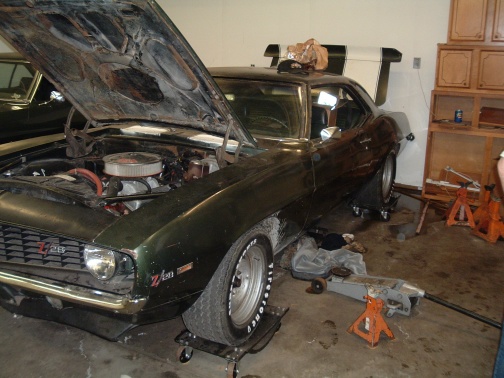

I have a friend that will be listing a JL-8 car for sale on ebay tonight, when he lists the car I will get the item #. The car is an X33D80 car in Fathom Green. Price is $30,000 firm and the car does NOT have the original motor in it, however it is being tracked down.
Feel free to email me, [email protected], or PM me with questions.
I had to resize the pics to post them, I can email non-downsized pics for better detail.

Ok now how many Fathom Green JL-8's did they make? Fred where is this car from/located now. Could this be the one I saw in and Elgin classic car dealer circa 1980? Just curious.

Don't know how many they made, but there is a Fathom JL-8 here in SW Pa. Has been around for quite a few years. Looks to be fairly original.

Don't know how many fathom green JL-8's...as far as I know this car was in Iowa at that time.
