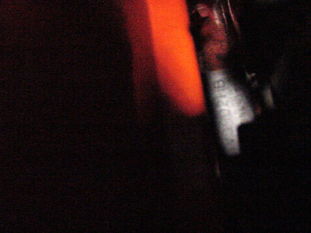

This time with a 67 Z28.
http://cgi.ebay.com/ebaymotors/ws/eB...tem=2422076684
10D X083
67-12637 LOS 4264
732-Z D-2
EX 2LG 3BSDL
4L 5BY
Only two problems, three if you count it being a LOS car. One the first batch of Z's weren't built until the last couple of weeks of decmber 66, and two the 4L code on Z28 trim tags wasn't used in October of 66, since there weren't any Z's at that point.
Plus it was an LF7 M35 car 2 months ago.
Aren't registries wonderful.
Mark C.
My Pace Car
Attachments - The Supercar Registry 44737-blockstamp_9N693637.jpg 44736-engstamp_9N693637_V0925DZ.jpg 44732-MVC-246F.JPG
