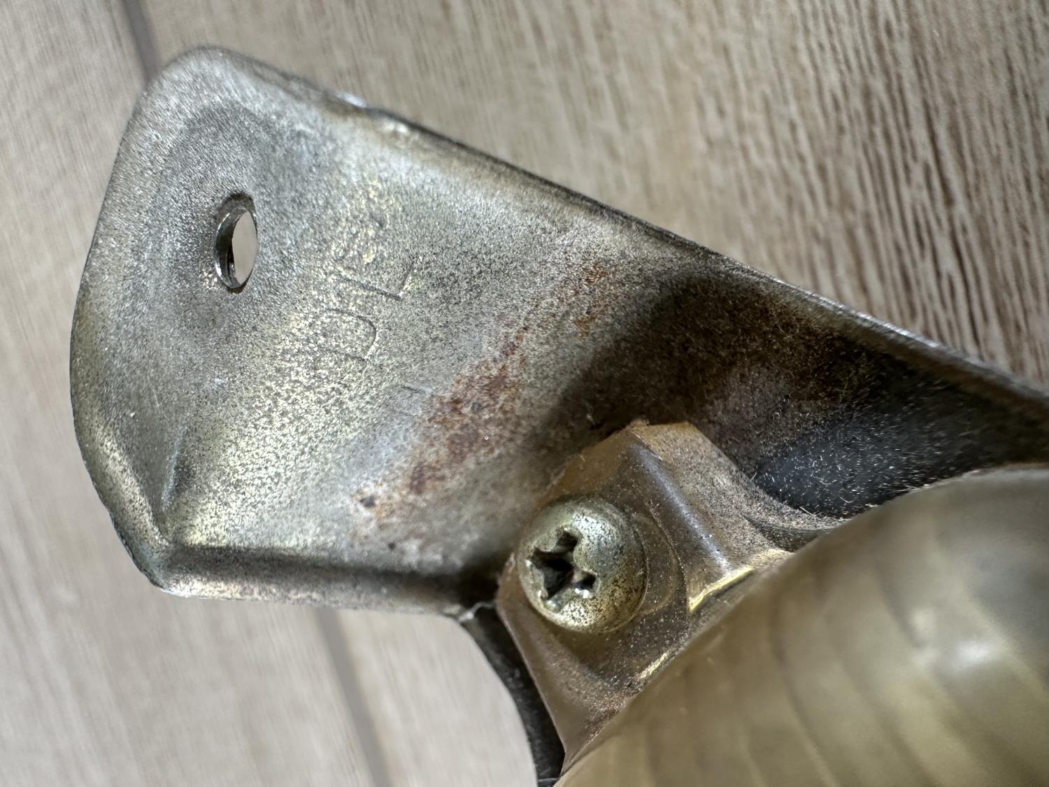

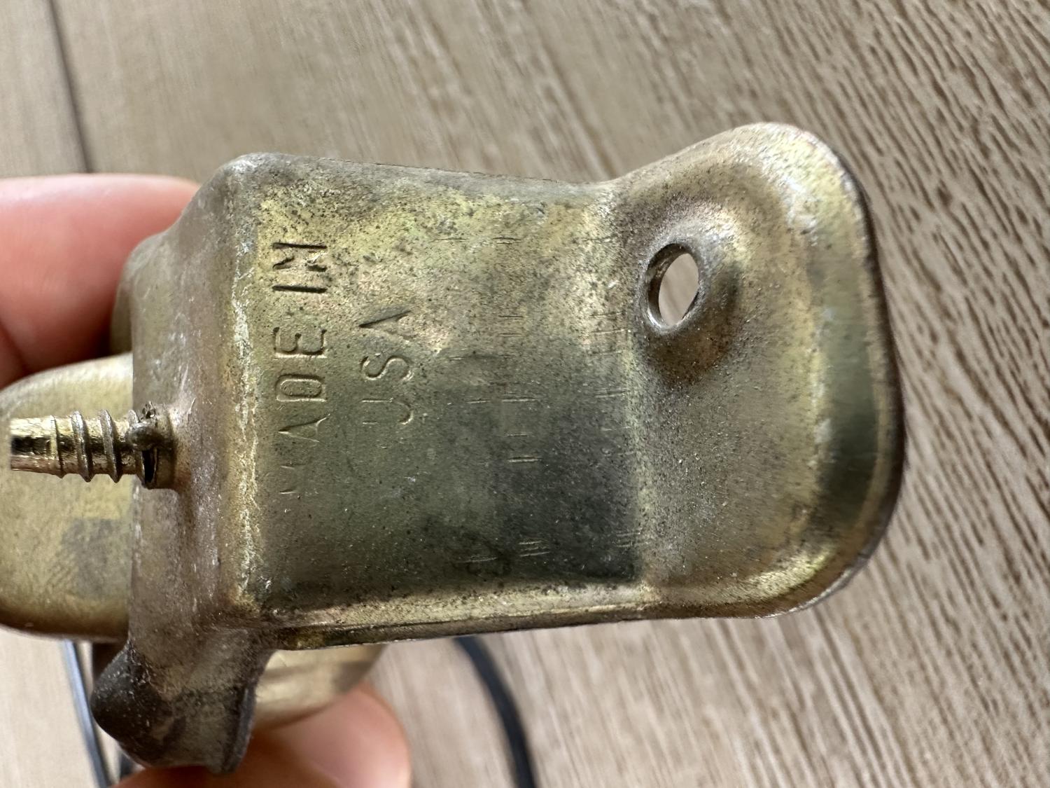

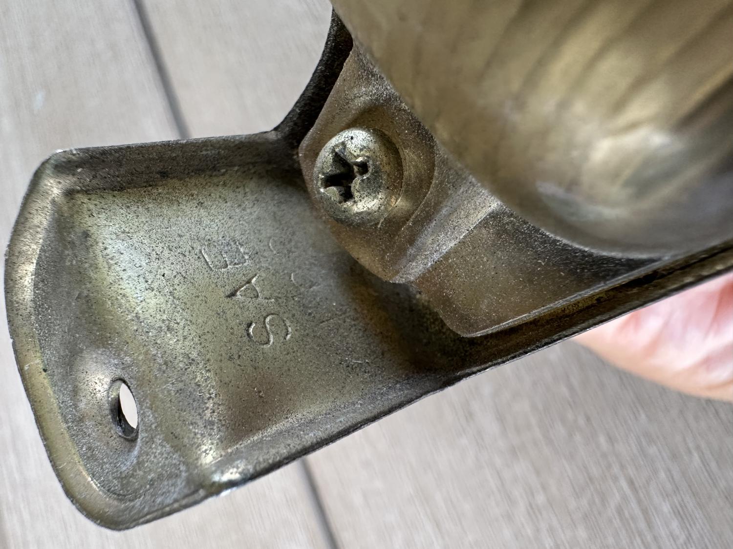

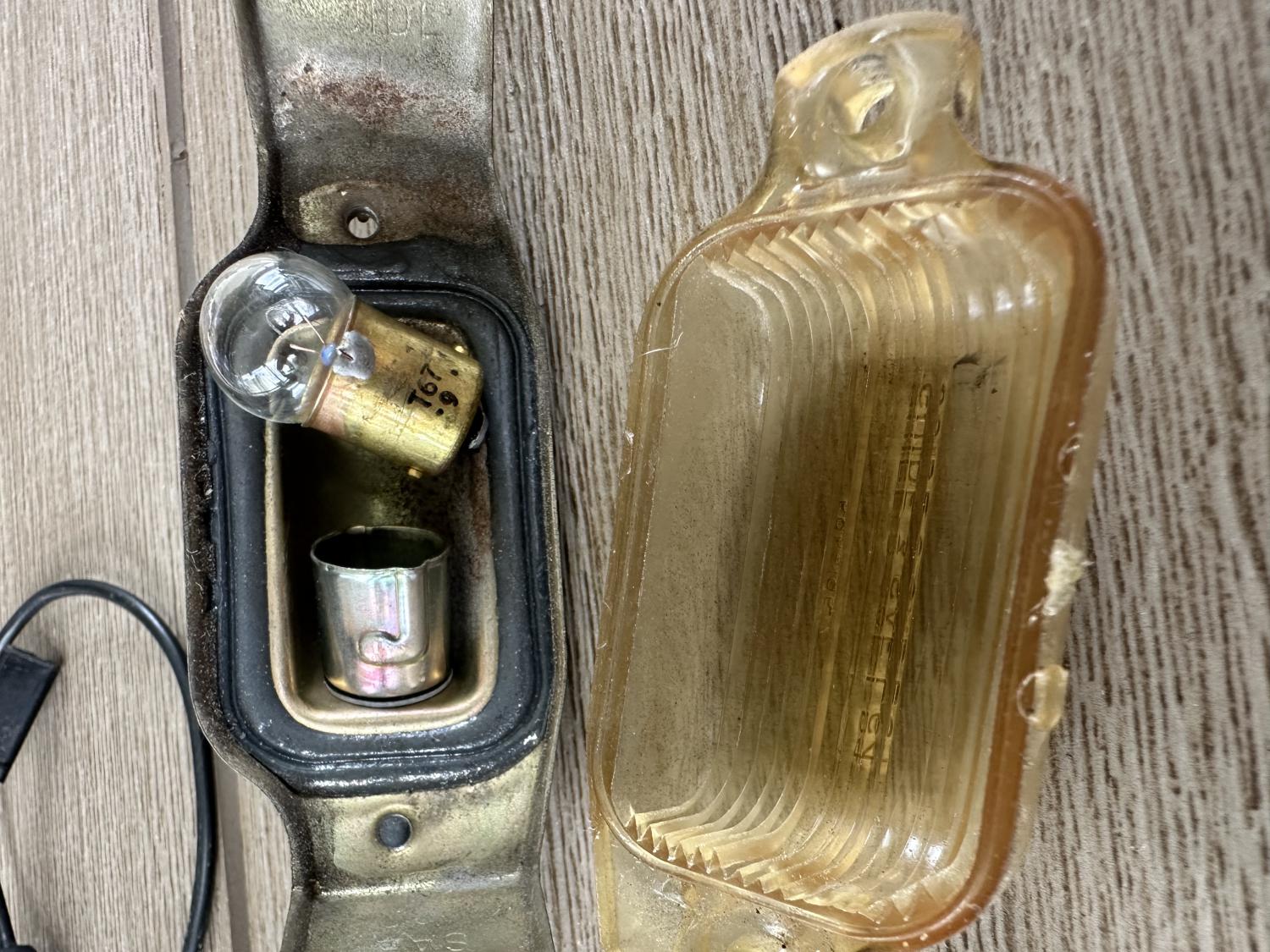

I’m trying to confirm fitment and originality of this license plate lamp. What car or cars does this fit and is it an original piece or reproduction?

Looks like it could be a 69 Camaro light. GUIDE is the OEM, so likely original. Lens has a part number, look that up (photo was blurry and I could not read the number)

lens fits a bunch of stuff
This NOS one is -10.
Yours is -7
Mold numbers probably
Do not have a NOS lamp assy but can check a used one later.
Chevelles only here.
