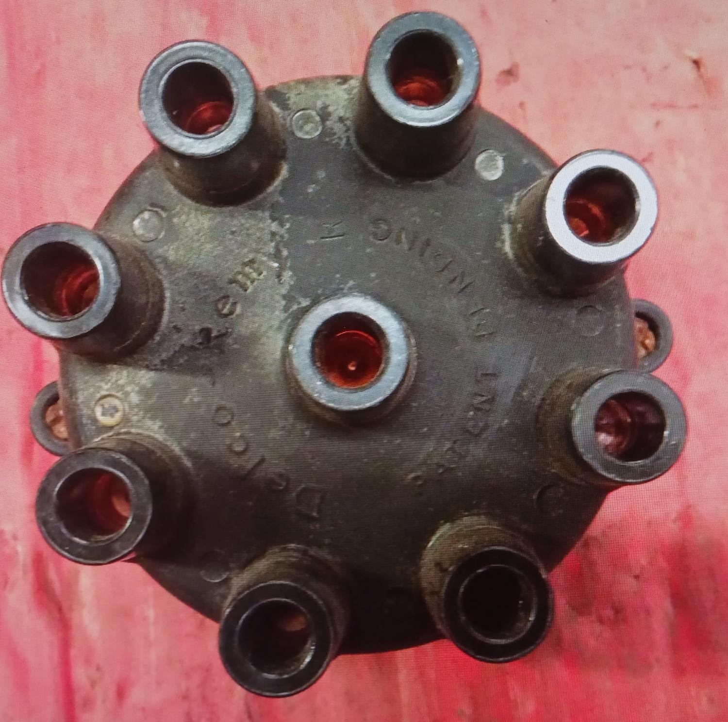

Pic 1 is the "R" cap we bought for it.

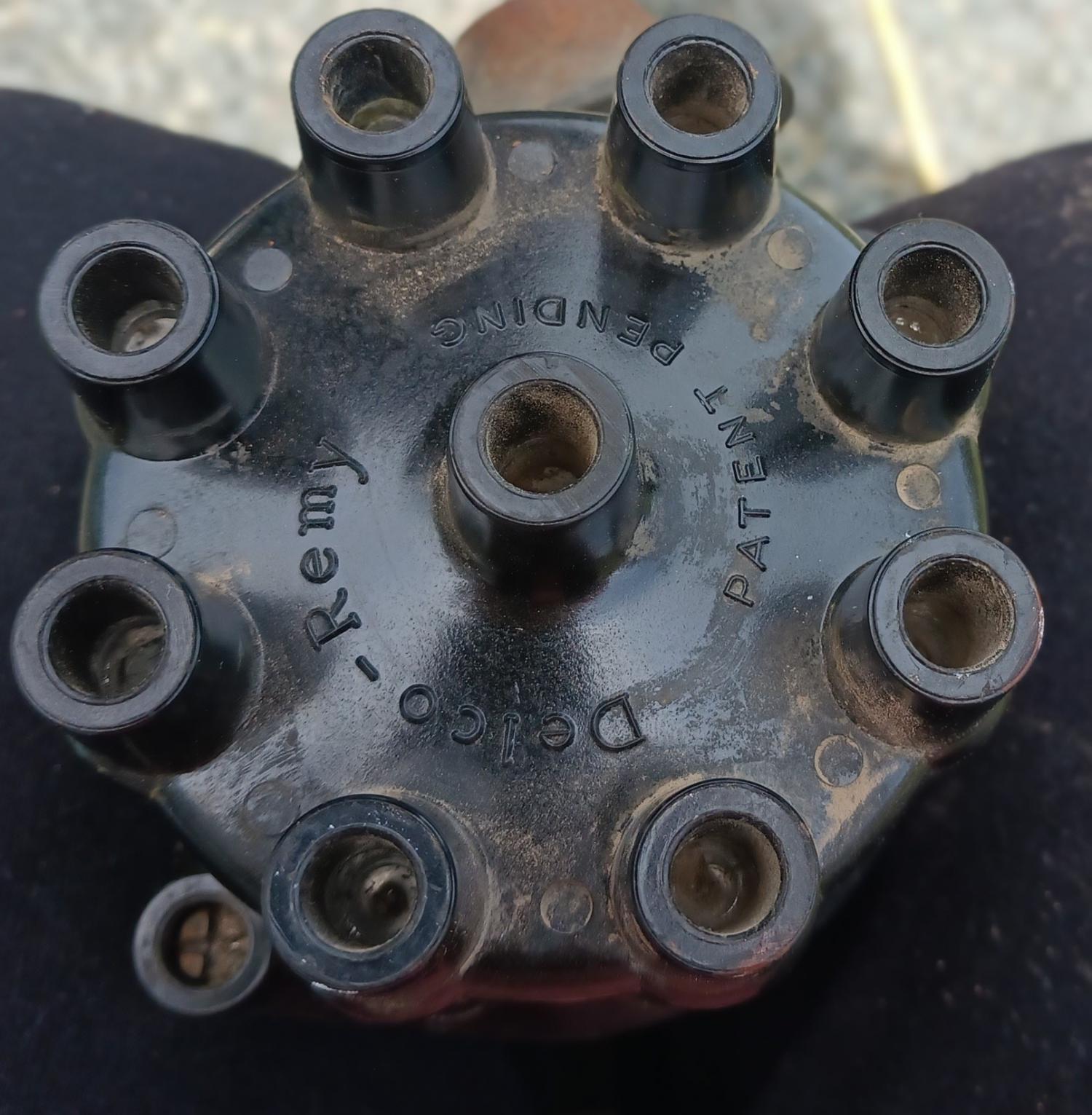

Pic 2 is the no "R" cap that was on dist.

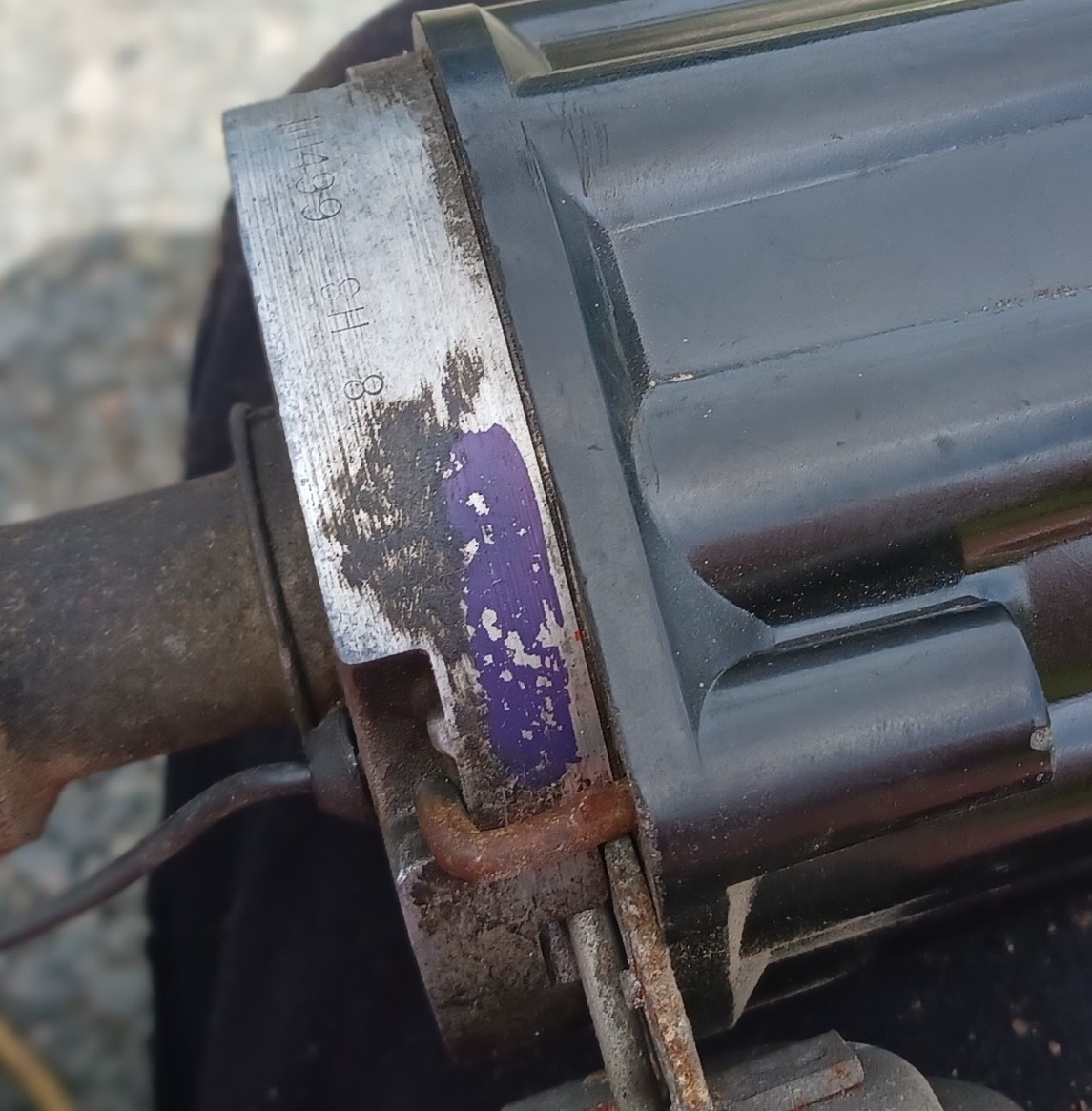

Pic 3 is the coil that came with car

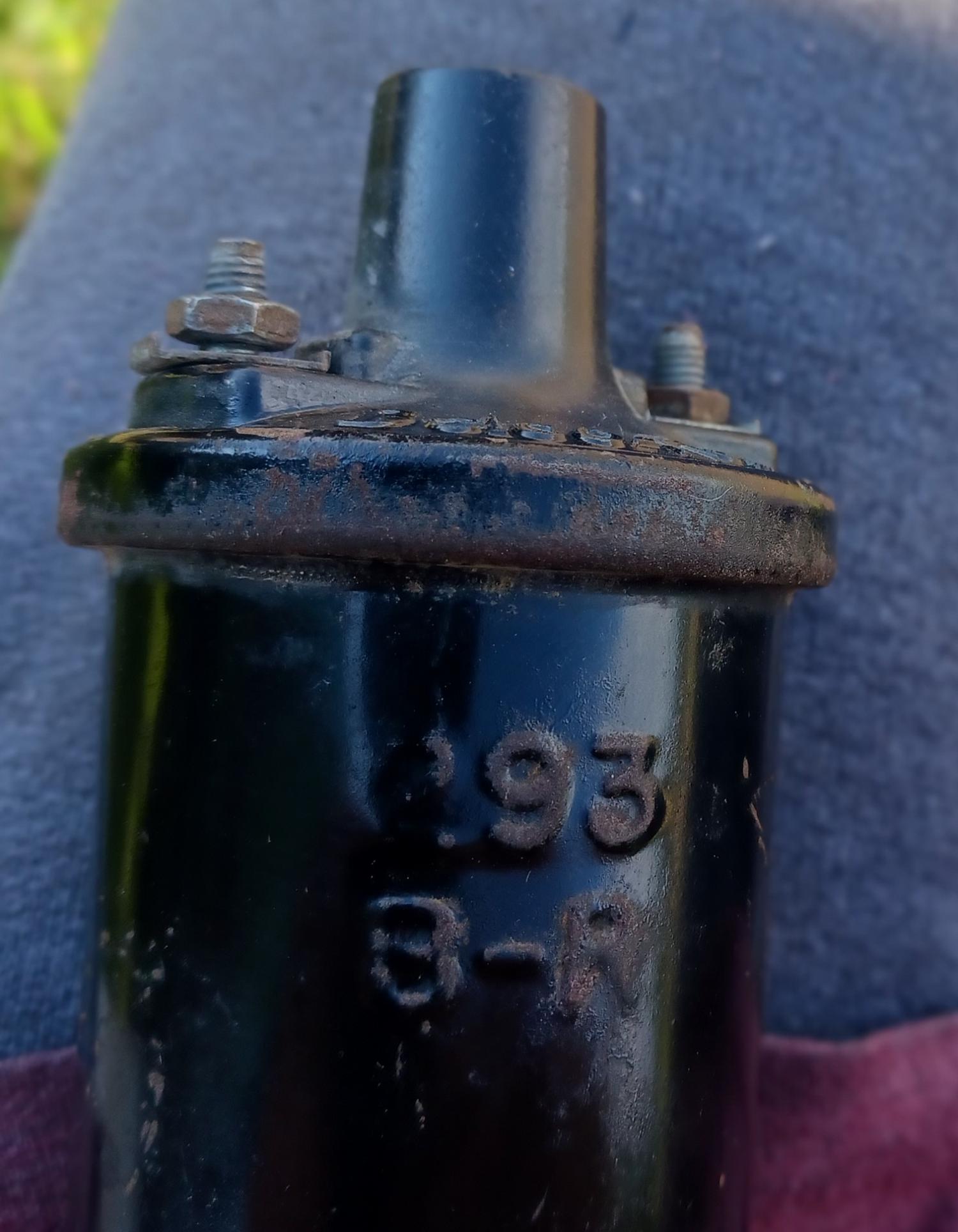

Pic 4 is date and purple ID paint on dist that came with car.

early and late "patent pending" caps.
Pic 1 is earlier type. No "R"
Pic 2 is later type with "R".
They are saying you need bottom type.
