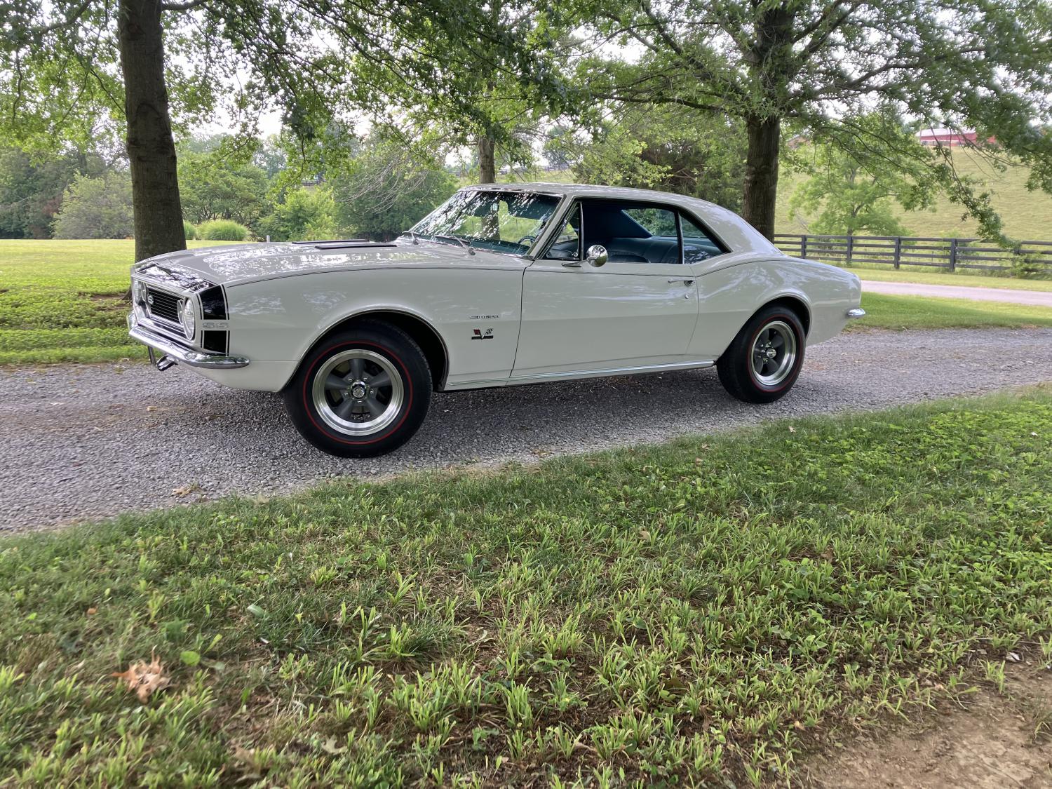

I like American Racing Torque Thrust on any car. These are 15x6, IMO they’re just a cool 😎 wheel. These tires are Coker red line radials 205/75R/15, no rub!
Those look great, I have 215/70-15 redline radials on my '68 Z and they also fit well.
