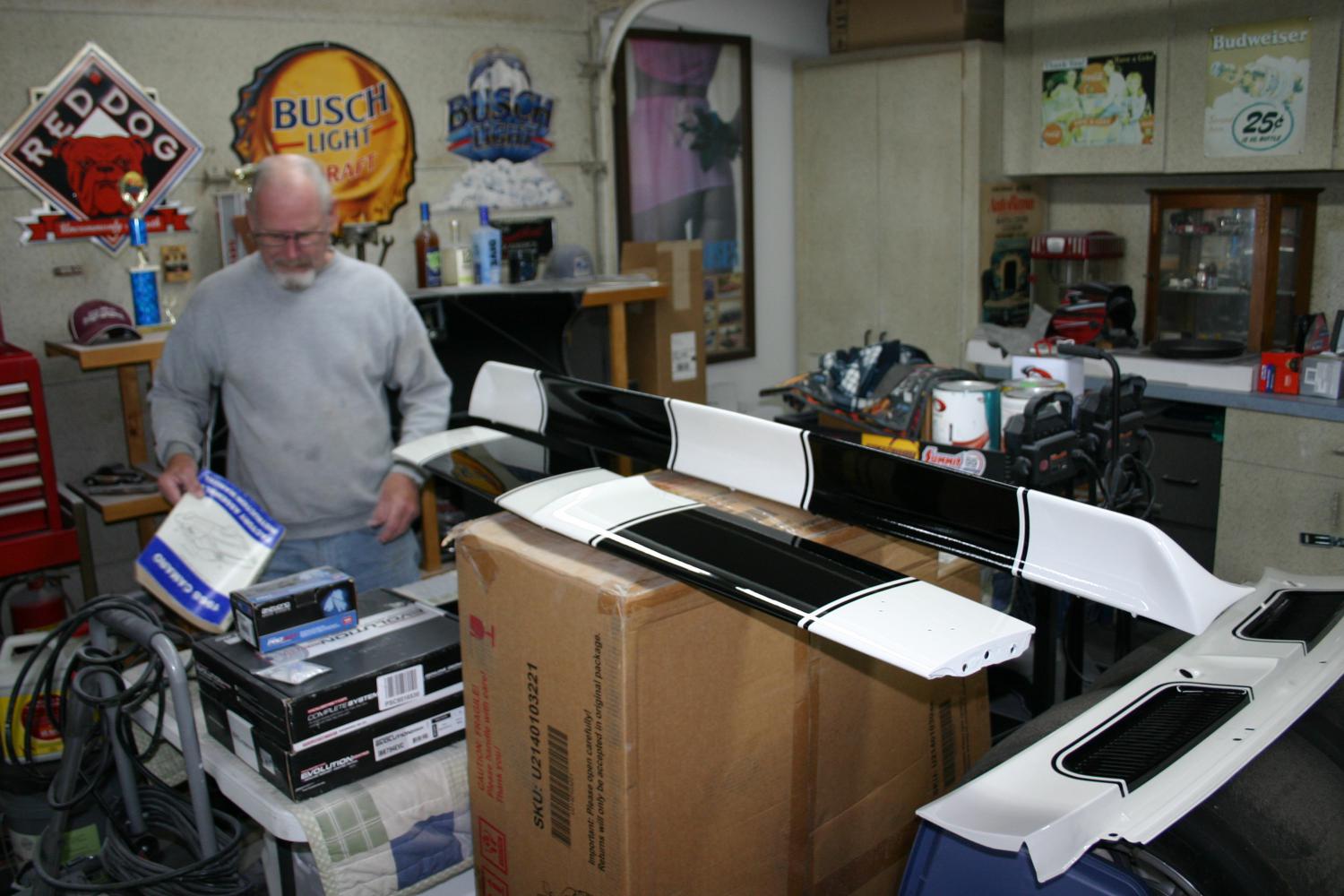

Here is a thread where we went thru this topic on a paint forum. The pros gave me some pointers. Like you I want the stripes on top. Here is a mock-up I did and think it will work out good on my car. Single stage white over bc/cc. I used Utech 350 for the white. It covered well without having to layer it on thick.
