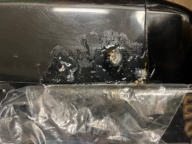

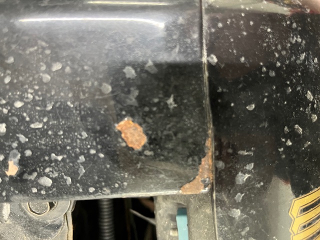

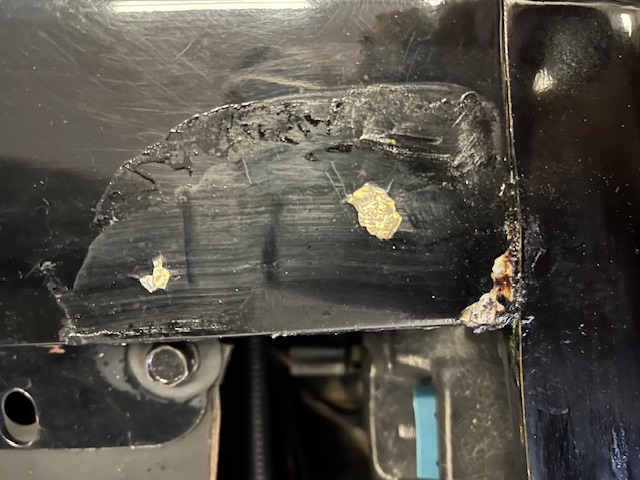

Hey Lynn, I have been dealing with this issue on a Survivor Trans Am and this is what I used. It's a gel, took about 4 days of re-dabbing then re-covering it with the plastic GLAD cling wrap. I will just touch it up from here...
