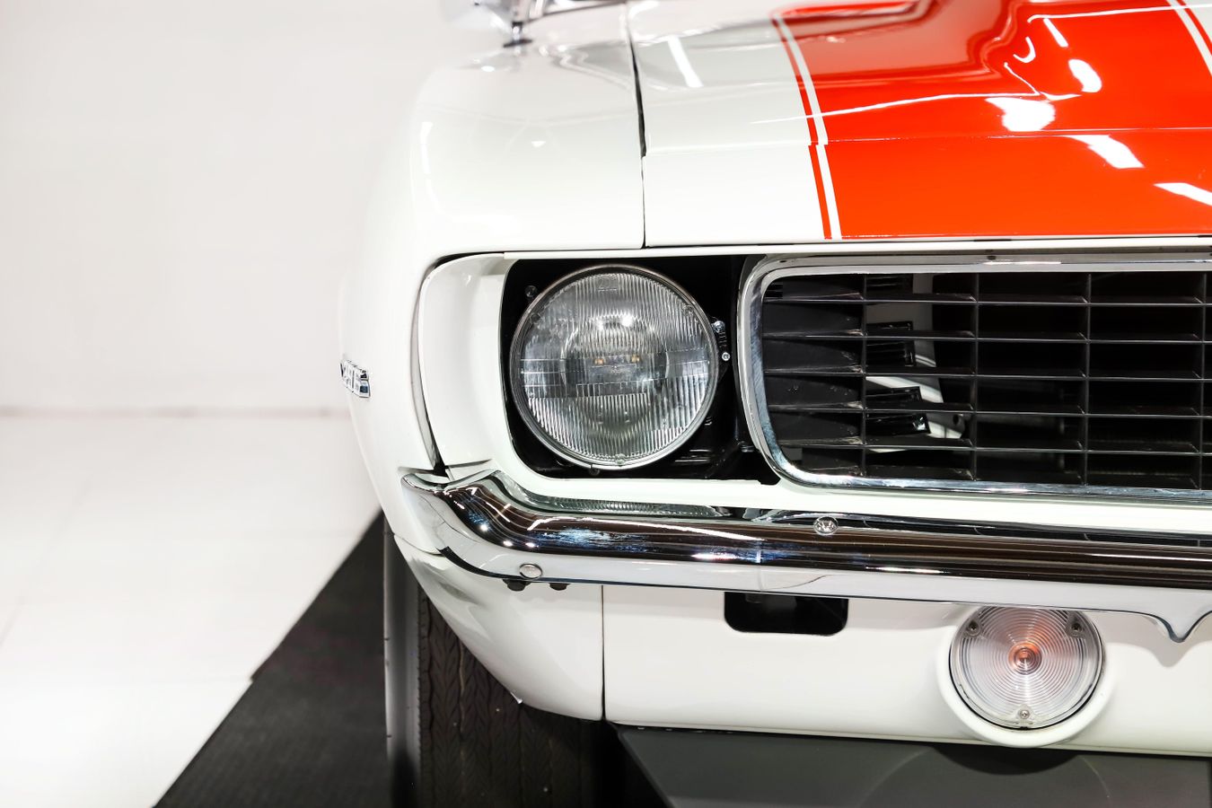

For $159,000 I would expect alot more than what I see.
The transverse muffler looks like it was used as a jacking point at one time.
The fit of the aftermarket grille is bad.
The RH back up light is crooked- possibly from new holes cut
The front end sheetmetal and alignment is poor. Hood must have been painted before it was fit as the stripes dont even match up with the upper valance striping.
Lots of other things that are not right. Square VIn cutout on dash means that was replaced most likely due to rust.
Chinese brake booster
Theres way more but just these few things doesnt speak to a high quality resto, nor the asking price.
But the VIN and cowl tag look like they are legit but both were most likely off the car at one time.
