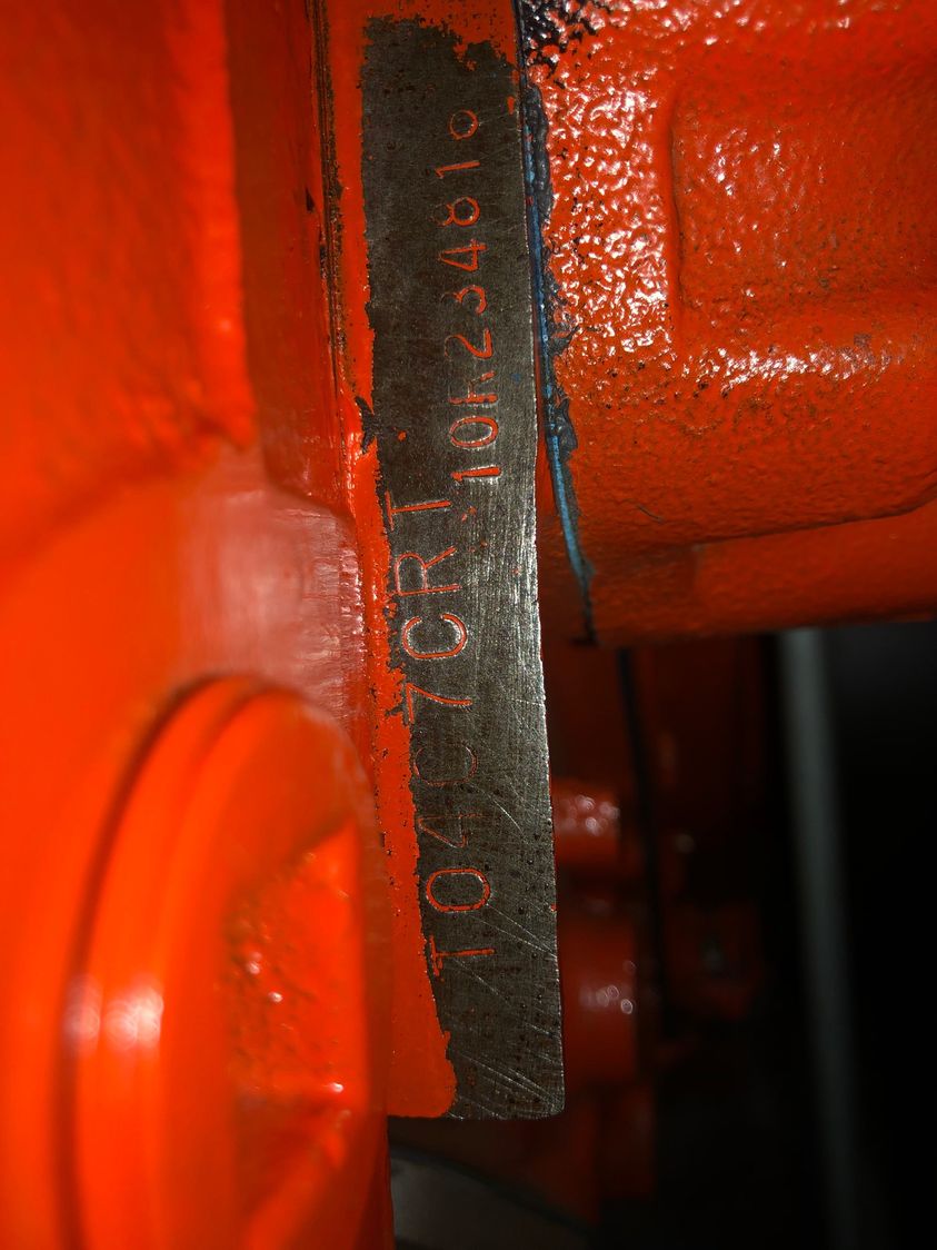

Thoughts on this stamp

I like it.
I don't like the lazy screw driver scrapings.
LOL.. Wasn't me. I cleaned it off with carb cleaner..

Someone abused the pad but I think it’s a legitimate build and VIN stamp.

Looks Legit to me.

What is the last digit? Kind of looks like the bottom of an 8.
Supposed to be a 6

Legit stamp!!

Thank you for the responses and confirming my thoughts. It is the born with engine in my Chevelle.
