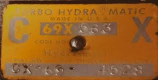

I have made a decal to restore the trans ID tag. The stamps used to impress the #s are very very hard to find with the correct font.

Old 07-05-2023, 09:35 PM
67 442 67 442 is offline
Join Date: Jan 2008
Location: Wisconsin
Posts: 284
Thanked 95 Times in 26 Posts
Said decal.
