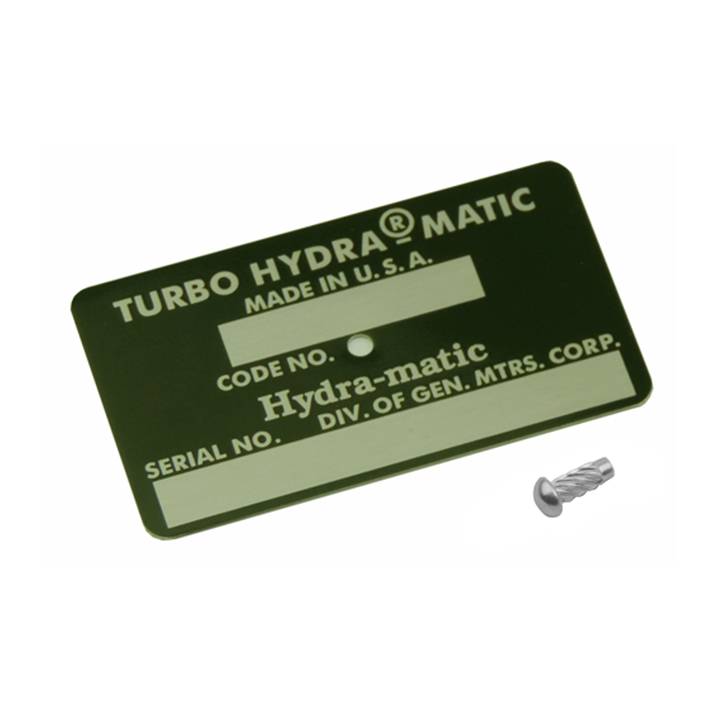

Consider using this. After removing the tag and striping the paint, spray on and rinse off, it can work miracles on raw aluminum. Do NOT use on polished aluminum though.
Metal items like the governor cover and bail Evaporust may work well. - Bill W

The tag on the passenger side of the unit will tell the story on the trans.

Can you help me understand how to remove the ID tag?
I can't figure how to remove the rivet.
Old 06-26-2023, 09:29 PM
Posts: 21,008
Thanked 3,705 Times in 1,491 Posts
Take a pair of Vise Grips and try to grab as much meat of the rivit head as possible,(try squaring it with a file beforehand),then twist & pull out very slowly.
If it's really in there and won't release,drill it out with a slightly smaller drill bit.
