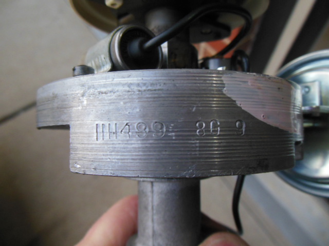

Got this in a box of parts today

Restamp.

Known date ….the “4” triangle are filled in correctly….the “9’s” are filled in on the back.

Known date yes, but is it an original stamped distributor? The other 499 in the post below (Rumblegutts396) so far was deemed fake and has the same filled in as you mention and date. Just trying to learn here is all. Bill

yes - a clearer picture of the "4" and "9"s would be helpful.

Lines go up to top of distributor. Try a cap on it
