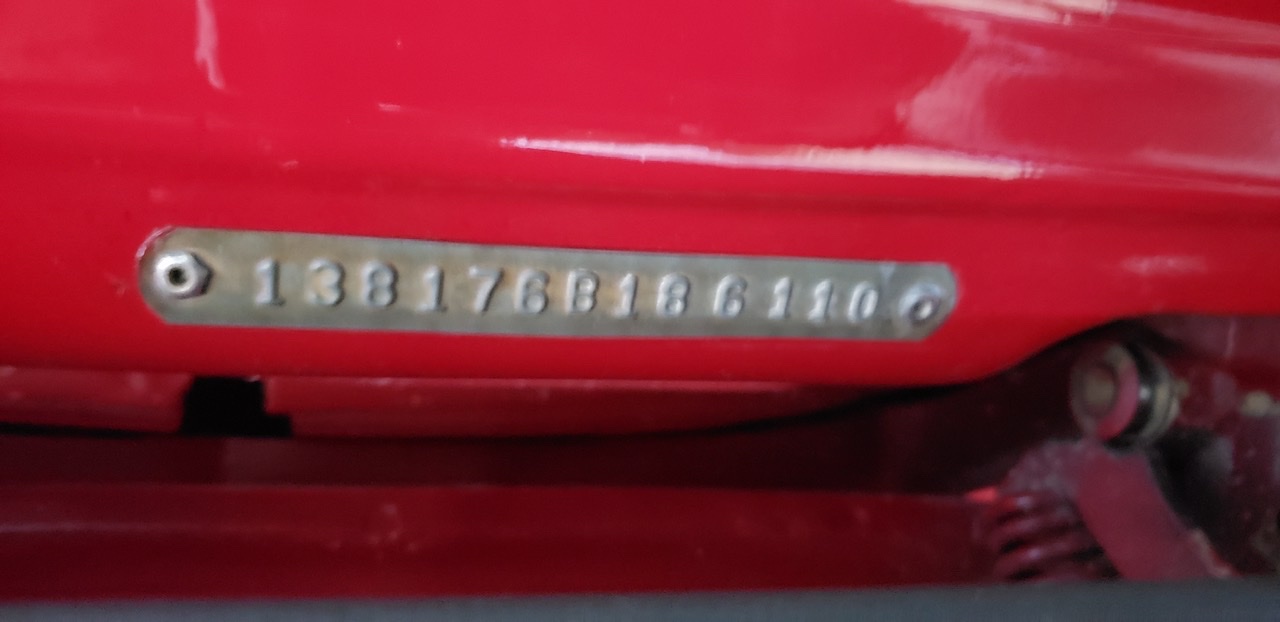

So I saw this listing. Request for photos of all tags and stampings.
Good fast reply. Now I’m no Expert but I’m thinking this isn’t a factory vin tag LOL
https://www.hemmings.com/classifieds...e/2550816.html

1 of 100...what??? Screws holding the rocker moldings on is a nice touch And that VIN tag? Run Forrest Run!!

forget about registering it in arizona, inspector would look at that vin tag and laugh

Wow. Just wow. That would not get past the NC DMV inspectors either.
As to the engine stamp, Baltimore plant was gang stamping the VIN by the time that car was built, so that stamp is bogus too.
Wonder if it was even a 138 car when born? Would not be surprised if it started life as a 6-cylinder powerglide Malibu!!
