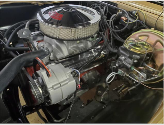

Hopefully this is an easy one but I suspect not, anyway....when I bought my 67 Z last year, it appeared to have some original paint still on it. One of those areas is where the firewall semi-gloss black ends at the top and transitions to body color. It's a Norwood car and it appears the line was masked. The Harry Mann 68 SS built in LA also has a masked line. Where the confusion comes in (for me at least) is a well-respected restorer here in Michigan seems to blow-in the transition, even spraying body color on the trim tag. If you look at a couple 67 Zs on the Heartbeat City website, you can see evidence of this. I understand that depending on the day or shift, plant workers on the same job may have done things differently but it appears the norm was a masked line perhaps specified by Fisher Body. Can anyone shed some additional light on this?

The cars restored with the body color on the front of the firewall and over the tag never look quite right to me (personal opinion). Yes, there are some examples of cars where that happened but usually it is fogged on when GM did it and when redone it always seems to have more thorough coverage. The typical Norwood '67 Z had the stripe color contained under the cowl panel, sometimes crisply masked off under there and in other cases it is sprayed there without being masked. The ones which were not crisply masked under the cowl panel did sometimes have stripe color which extended more toward the front of the cowl. Below are some '67 Z Norwood examples. The typical LOS '67 Z, which yours is not, had the majority of the top of the cowl painted with a distinct masked line at the leading edge, but I have seen one example prior to restoration where it was crisply masked off under the cowl panel.
