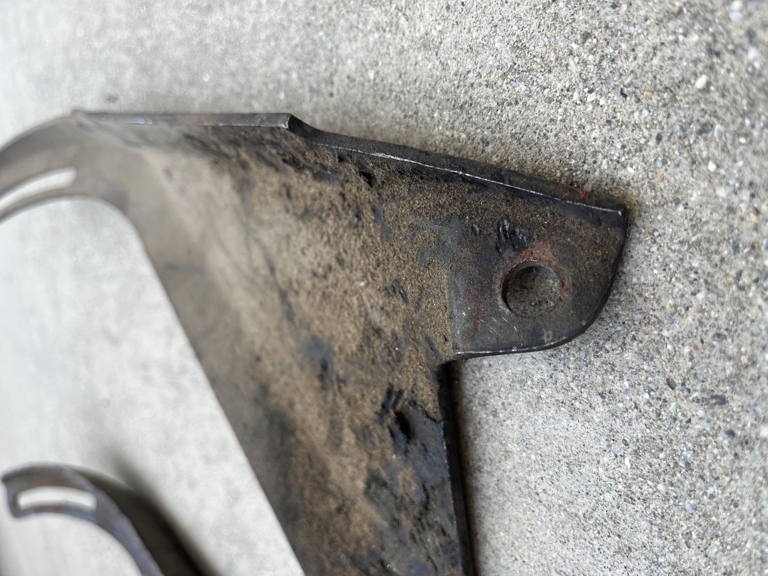

Hey again, I have several original GM ones - both with the return spring bracket and without.
Here are photos of both designs.
PM me with any interest in the no-bracket one for your '67 build.
