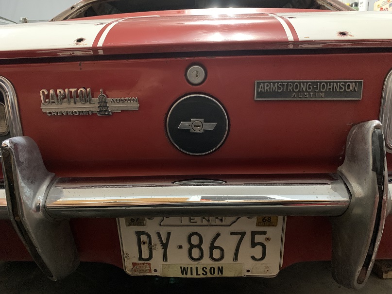

I was fortunate enough for a good friend to have a good eye and located me an original dealer emblem from Capitol Chevrolet. Thanks Bentley. As you can see although the emblem is a newer design without the attachment pins for the emblem which would have been later replaced by adhesive the location of the ejector pin locations match up perfectly with the original holes that were placed in the tail pan.

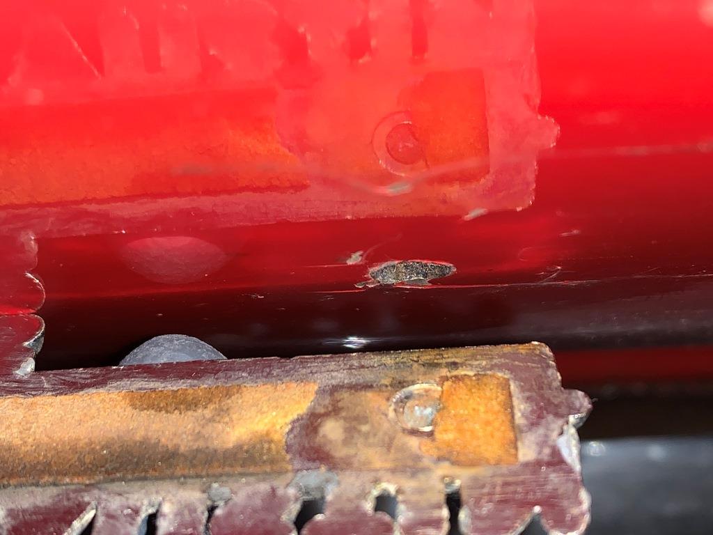

While I work my way around the backside of the car I continue to use the same procedures mentioned above. Some things to note. The car, at some point (I can confirm prior to April '72 when Dixon bought the car), had been tapped in the rear and I believe that is when the spoiler was added and the trunk lid reshot and a touchup area on the pass side quarter. I will leave it as found as I do not want to disturb the condition of its history. You can also note the original paint along with stripes which were under the spoiler and once an emblem is in place you can see what's left of the cut out of the stripe for said emblem. I will not this later on as I had to find an original replacement emblem as they did not move the emblem when the spoiler was installed. Underside is still original and the remnants of the jacking instructions along with glue residue from the posi traction decal. I will document those later in the process when I begin the trunk area clean up. Now to the photos.
Photo 19 - Another shot of the roof after final process. It's still show imperfections like stains etc. Unfortunately I do not know of anything that will rid them from the paint surface as it embeds deep into the paint.
Photo 20 - Trunk Lid before.
Photo 21 - A little sanding brought out the original stripe under the repaint on the lip of the lid.
Photo 22 & 23 - Trunk lid after. You can see how the reshot did not hold up well over the years. But again will not refinish. You can also see that the pass side bumper guard does not sit flush on the bumper. This is due to what I believe was also part of the rear end bump it obtained. I will have to replace it with an original replacement due to the lower bracket that is welded to the guard broke its welds. I have several used guards so this will not be an issue. The primer sprayed on the drivers quarter and upper quarter and sail panel will be addressed. I will remove this primer and keep whatever is underneath up to the surface.

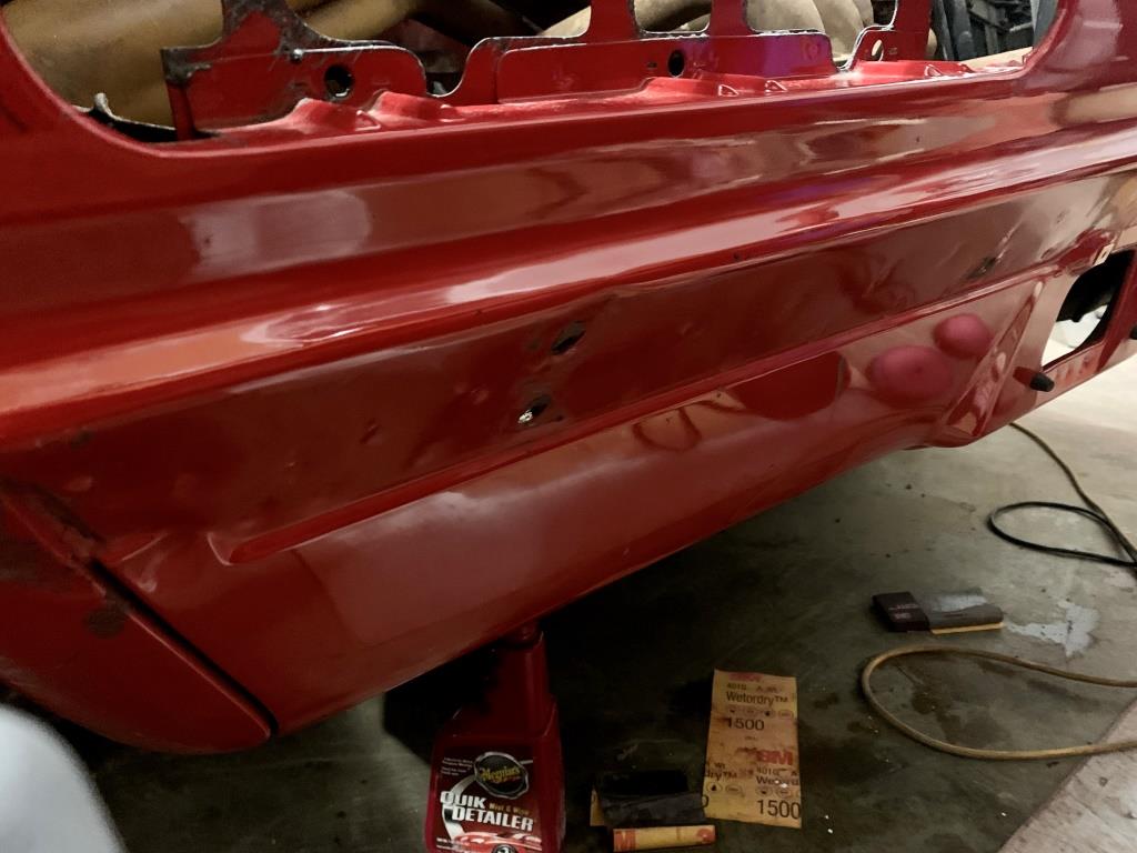

Photo 24 - is the tail panel before being stripped down to begin cleaning of this area.

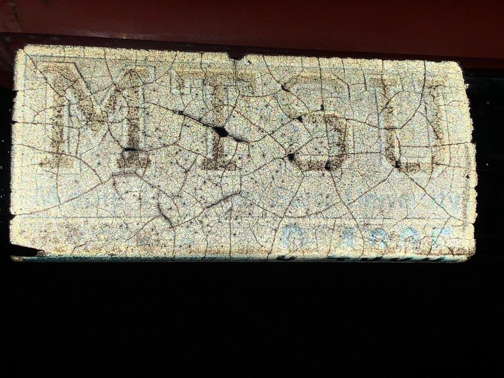

Photo 25 & 26 - That decal is a parking sticker for a local University here in TN. Middle Tennessee University and is dated to expire in Aug 15 1976. This was when the previous owner finished high school and attended MTSU in '75 but never finished as he was hired on full time with the postal service in Nashville, TN.
Photo 27 & 28 - are the tail panel cleaned and prepped. Again using the same procedures listed in previous posts.
Photo 29 - you can see how the panel was popped outward around the guard mounting hole due to previously discussed tap. I will address this once I am ready to reinstall the components of the tail section. Also not that every bumper to body bolt and bracket had dum dum around the opening.
