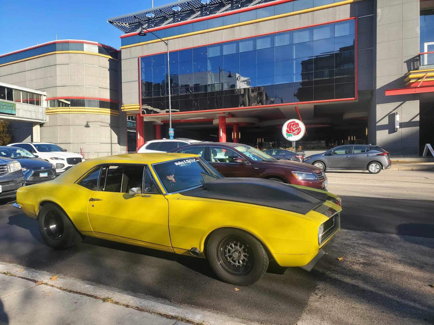

This is what I started with, I did a trade + got some cash to me, and picked up this 1967 Camaro that was a pro street car. Bought it near Rockford, car was supposedly from Lisle though I've not come across anyone who knew the car.
As it sat, it had a 502 later crate engine, 8-71 supercharger, T350, and a 9" with 31 spline guts. Has full tubs, ladder bars and a 10 point cage.

I'm an LS guy, so I already had the motor/blower sold, and as part of the deal we towed the car right when I bought it to a buddy's shop and the driveline was pulled a few hours later.
As purchased the car was sketchy. Wiring harness was garbage, it had drums all the way around and the shocks and suspension was old.

Buddy welded up the turbo kit, went in about 3 years ago. I then started wiring the car.
Along the way, I pulled the rear end, which is a super narrowed 9" / ladder bar combo. I decided to upgrade the guts from the 31 spline / supposed posi setup to 40 spline and a spool.

Was making good progress, had plumbed fuel system, gotten the car running, swapped brakes, made new brake lines, swapped shocks, front suspension, 9" guts, seats, shifter, wheels, hood, but then ran into rust under the windshield.
So I moved it from my house on the North side of Chicago to a buddy in Mt. Prospect who fixed it up.
Got it home, have been working through a list of final items which included cooling issues. Car is currently with a buddy who is working on cooling system and will do a final go over of the wiring.
I have driven the car an hour straight but it was running warm the whole time.
Goal is a rowdy cruiser that runs low 8s.

Thanks! Radiator and rearend had 'Hensley Racing' stickers on them if anyone recalls them. My buddy Al and I discussed what the car's history might be. Some of the work )9", ladder bar, tubs) looks like it was professionally built so the car might have been drag raced or it was just a nice pro street build. Someone later in the car's life added the GM MK IV crate motor and blower setup. Was originally F-F, then red, and now yellow.
