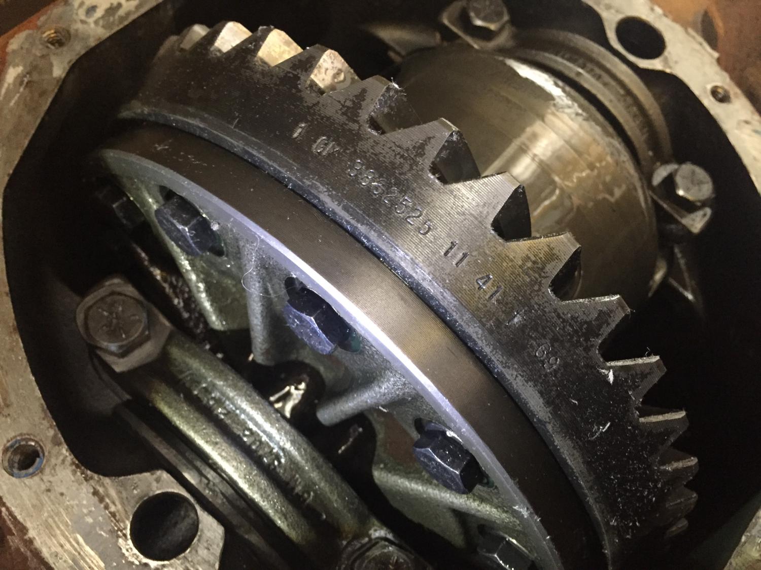

I wanted to start a thread documenting the teardown and restoration of my 69 Z-28 born with drivetrain car. The car is nicely optioned with Deluxe Houndstooth interior, rosewood wheel, black vinyl top, and D80. Car also has cowl hood, and endura bumper which may have been added. Removing the original exhaust system first. Note the chrome tailpipes.

Car Details: VIN 9N580062, 01B Build X77
More Pics:

More pics, paint will be stripped and the original Garnet red and Black Stripes will be added.
