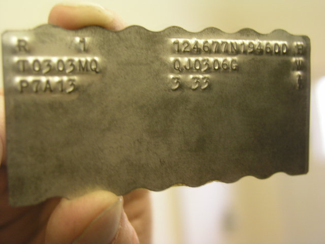

When I owned the orig. 67 Pace car I found just a bare Protecto Plate in the glovebox. It had been stamped but not in a warranty booklet.

Originally Posted by charley lillard View Post
when i owned the orig. 67 pace car i found just a bare protecto plate in the glovebox. It had been stamped but not in a warranty booklet.
mq. L78
Are there any MQ's built prior to 0303
I think grumpys car was the same date. This is the earliest date I believe
