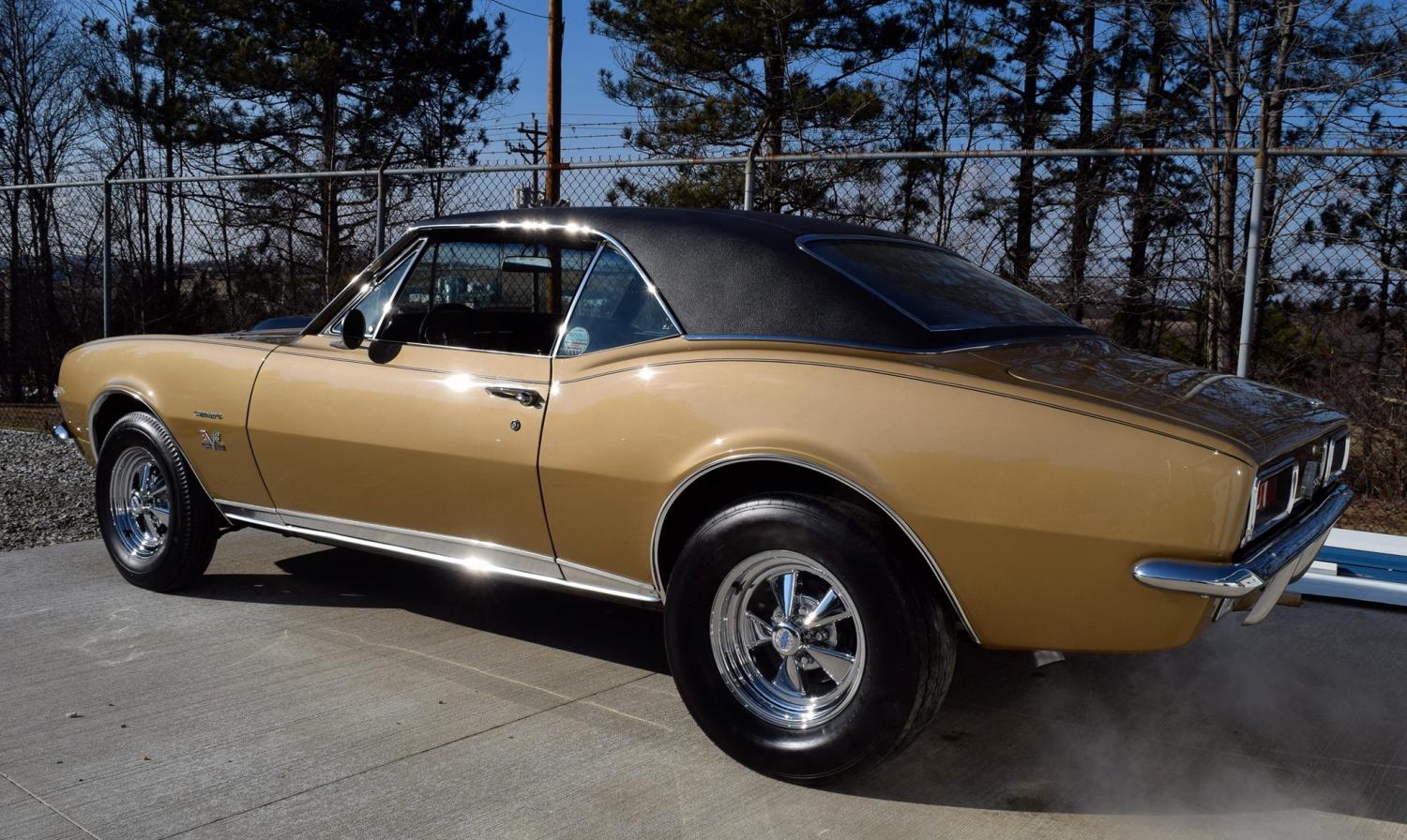

15x8's on a L60/275 tire fit nice on a 67/68 but I prefer a 15x7 rim with the same tire because it bulges the side wall of the tire for a little more period look. if I could only figure out how to post pics ? I have tons on my phone I could share

A shot of Jeff's 67 with Cragar's.
