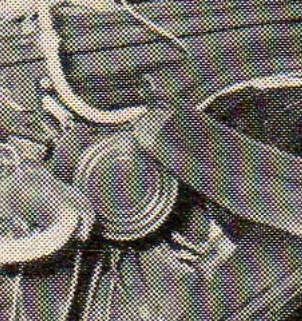

Original 1970 Chevelle road test pic.

William I have no idea what I am looking at.......

Why the ZL2 flange needed the flat spot on Chevelles. On A/C cars, the vacuum tank would contact the Camaro flange.
Warren's post cleared something up. The May '70 Hot Rod has a LS-6 Chevelle test. The engine bay photo clearly shows the flange is not the clipped version. I thought they must have continued the Camaro part but looks to be the second design. Possible only A/C cars got the clipped version.
Sorry, the photo won't scan.

Flattened area on flange lip there to clear the can?

I would say William's picture is to show the purpose of the sliced flange with the vacuum can.
