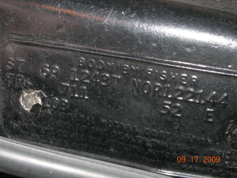

Took a look at this car in person today. I’m no expert, but this cowl tag is not original, right?
https://www.barrett-jackson.com/Even...RO-Z/28-236301
Attachments - The Supercar Registry trtag091809_resize.jpg 69214AFC-61D4-4D2A-80E1-561213DA24A9.jpeg 005.JPG

I don't know about the tag but Daytona yellow always had black striping no matter the top or interior color...Joe

Yeah, they specifically said that during the restoration the decision was made to paint the stripes white to match the vinyl top. They were originally black.

Agree. The ad acknowledges that fact: "Also during the restoration the decision was made to change the color of the stripes from black to white, which looks amazing."
Normal striping on a red 69 Z was black. My, however, has a white vinyl top, and so has white stripes. So would a yellow Z with a white vinyl top have white stripes?

Always black with Daytona yellow, regardless of the top color.
