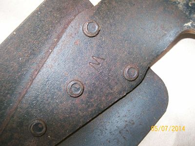

Here are some pics.Hard to really get good ones.

Looks like a painted flex fan.
The blades don't look correct at all
Just my 2 cents

fan not correct in my opinion.
