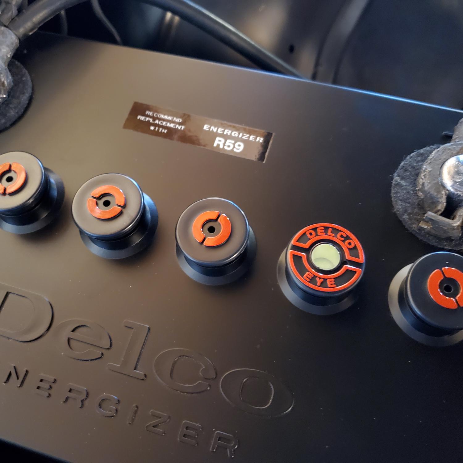

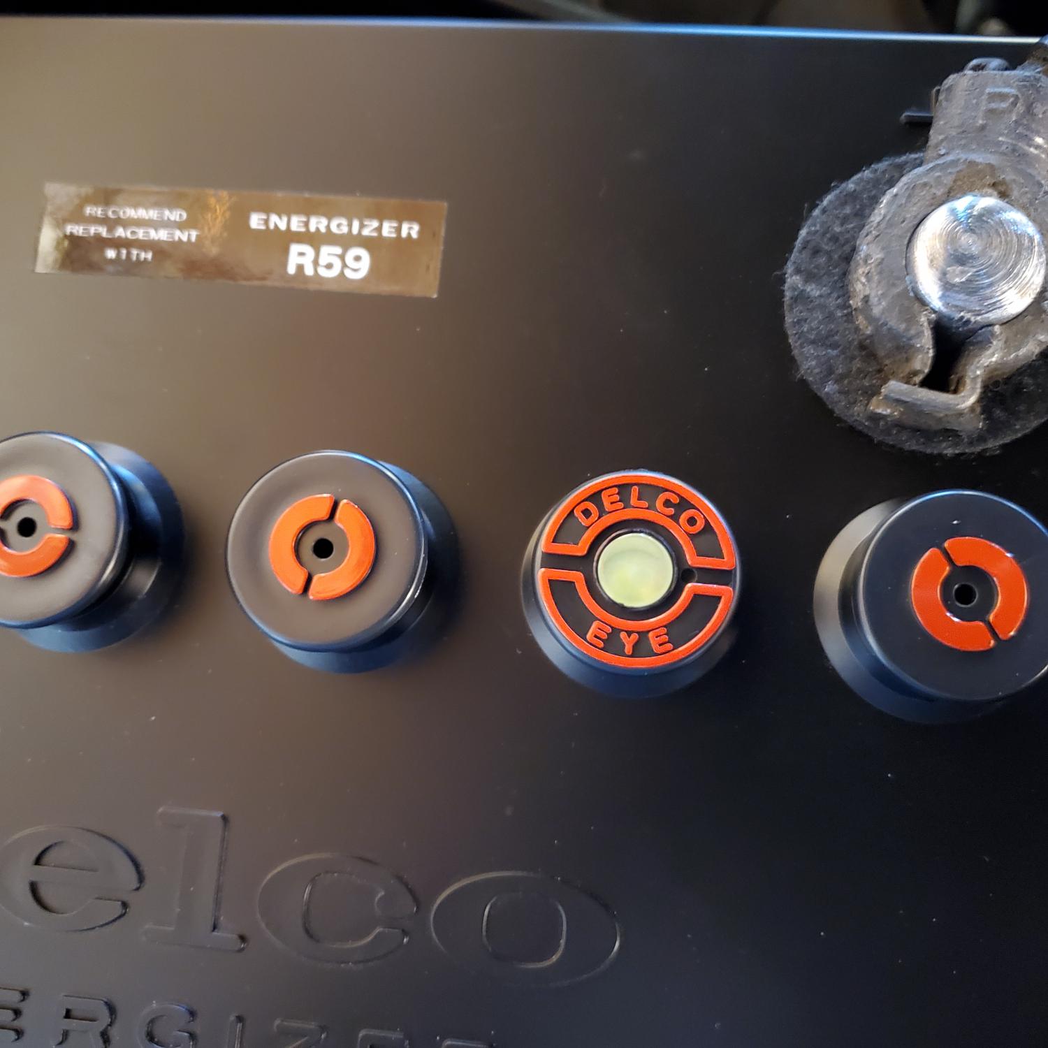

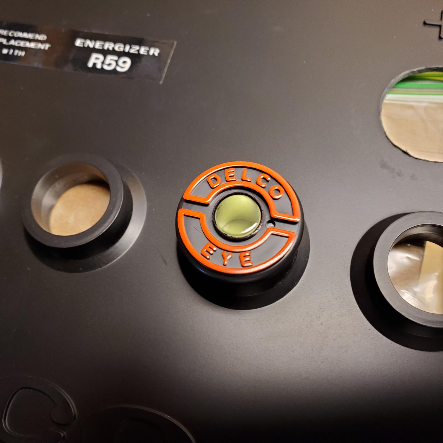

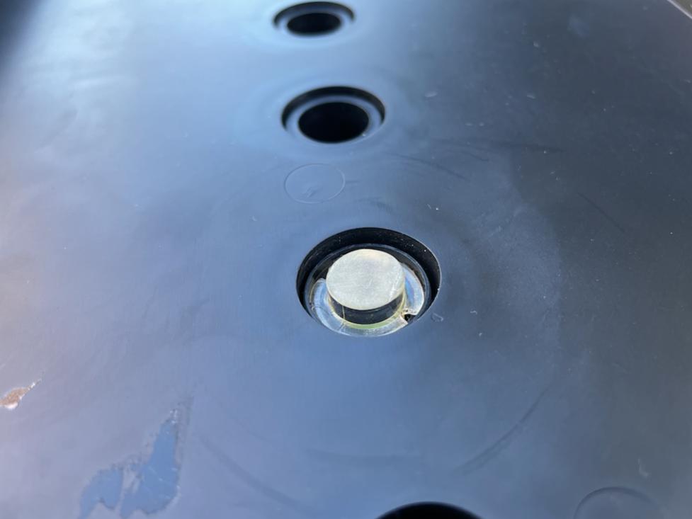

Finished up the Delco Eye this morning. Came out better than I thought it would!! Ended up using the green masking tape as you guys mentioned. I had to because the acrylic rod was so clear when I was done you could read the writing on the top of the battery through it!!

Looks good! I've been wanting to do that, but haven't gotten to it yet.

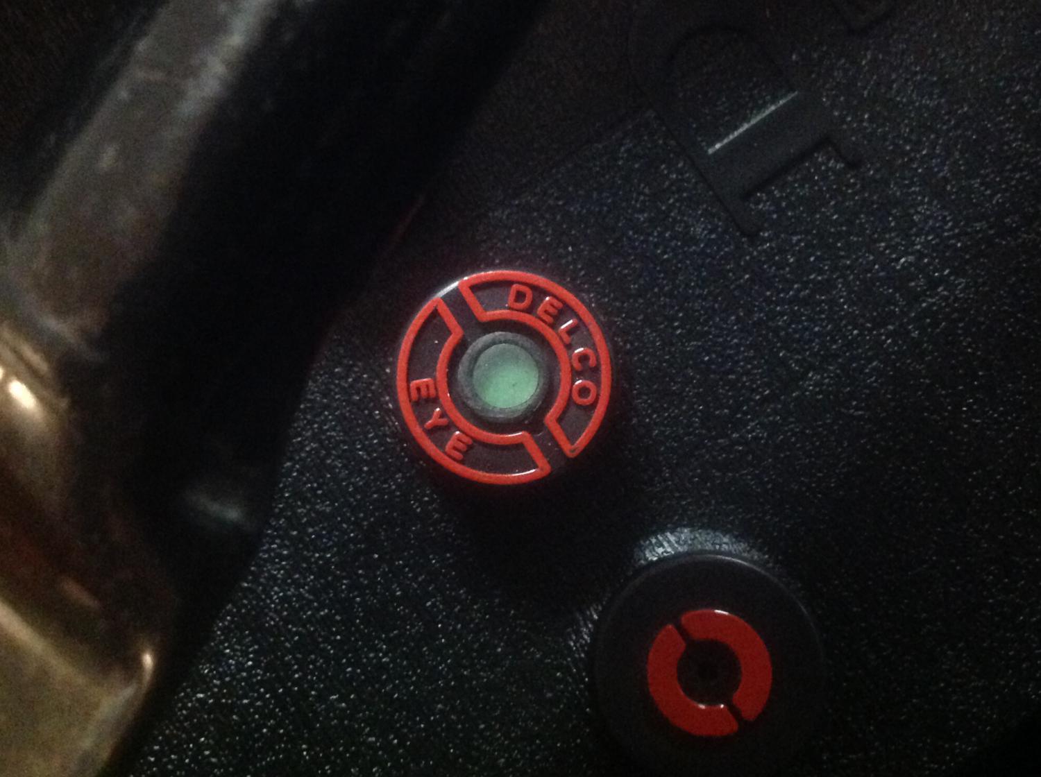

Do the “eyes” go green/ yellow?
