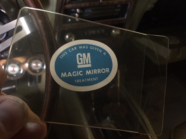

I bought this from a Ol timer that worked for GM. I had it on my windshield at MCACN hoping to learn more a out it as the guy I got it from was clueless. At any rate, happened on the line or at the dealer or who knows..... pretty cool paper. Anyone seen one before?
BIG
