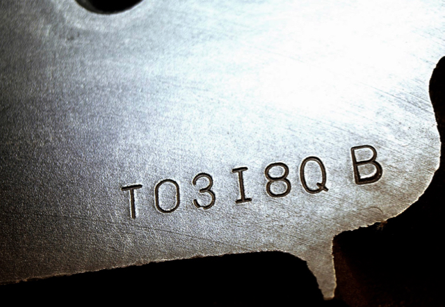

Not sure what to make of the engine stamp, but the trim tag looks real and calls out the factory 4-speed option. Beautiful car for sure, and I believe the claim that there's been $100k+ invested into the restoration.

Looks like someone tried to duplicate the broach marks with a hand scraper or chisel, appears to be restamped too.

That’s the worst attempt at faking broach marks that I’ve seen.

What Helmut said.

Obviously someone scraped and damaged the pad. I believe the 409 did not have the traditional small/ big blocks, fore-aft broach marks, although there were circular machine markings. Hopefully a 409 guru can shed some light...

That is pretty sad, scratching lines with an awl or something. I went through this with Verne a couple years ago. Apparently the relatively small volumes of 348/409 engines didn't justify the expense of the big planing machine that did that operation for the small blocks (and later big blocks). Thus production used a rotary machining operation for preparing the 74 degree deck surface of the W motors.
